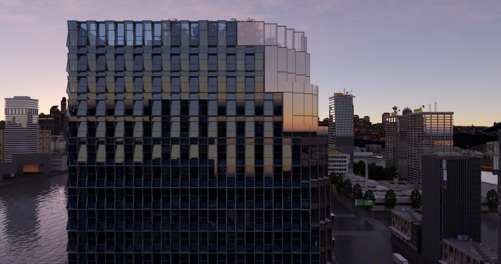

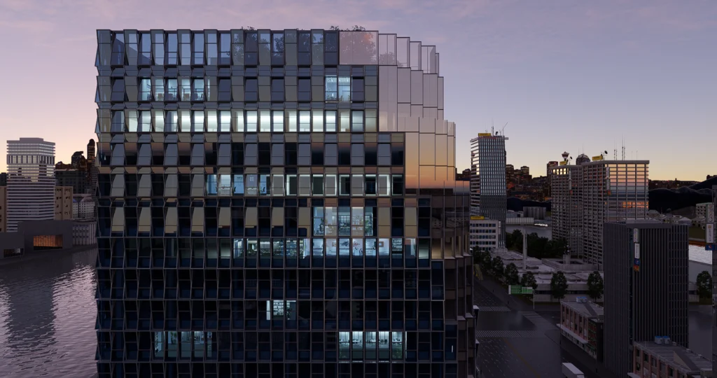

From dark, abandoned-looking structure to detailed, realistic office builiding.
-No need to purchase extra EXR/OSL parallax packs and import them into the scene
-No need to decorate the rooms inside a building manually
-No need to set lighting for each interior area
Fill the interior space with D5's ready-to-use Interior Parallax, and fake interior design in a snap!

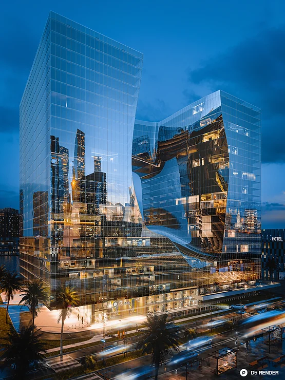

When it comes to archviz render, it is often the case that the visualization will only show a building or structure from the outside, but the facade would look dull and unrealistic without lighted windows, especially in nighttime scenes.
In real life, when walking past a building or a house, we tend to see through the windows for a look at the inside space. In this case, windows are not only a framing device for architecture, and they're supposed to fit into the surroundings in your scene.
If this is a night scene we're talking about, then a high-rise office building should be equipped with lighted windows that show offices where people are working or talking inside. The interior space should resemble a real working space, at least to some extent, with necessary office facilities. For a shopping mall or commercial building, fancy shopfronts would be expected in the scene.

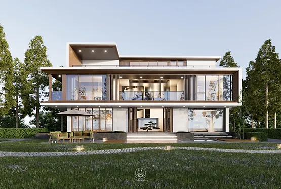

There are currently two types of Interior Parallax: residential, commercial.

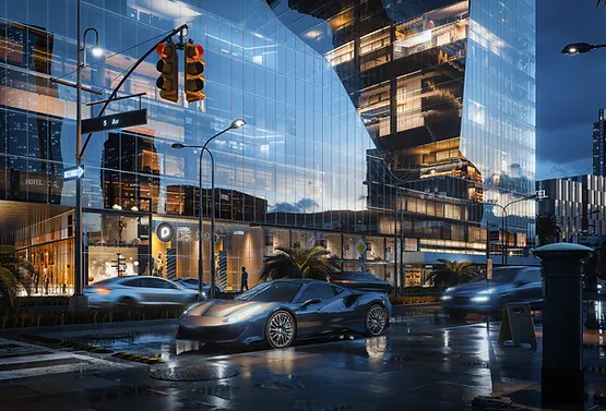

For floor-through offices, we also have several ones for you to fill in a window measuring longer in width, and that's also a time-saver.If you're rendering a business center or a shopping mall, just drag and use such window displayInterior Parallax with plastic models inside for clothing shops.
These should be a time-saving tool for most of your projects, be it residential houses, apartments or high-rise, complex projects.

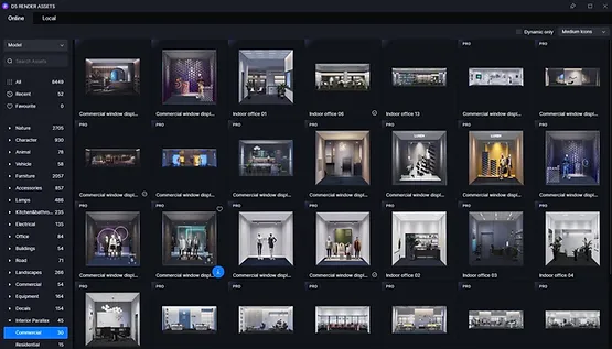

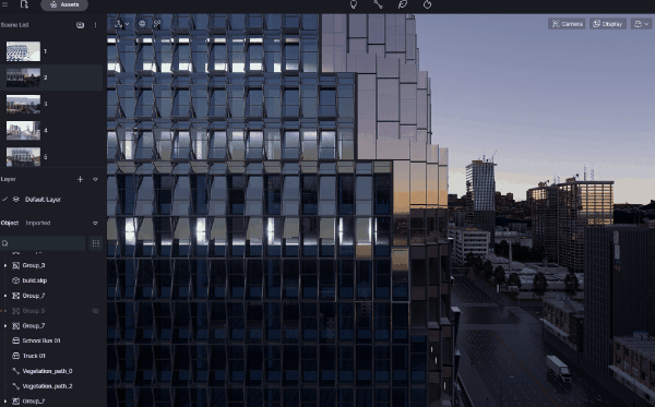

Choose from various interior parallax assets in D5 Asset Library - Model - Interior Parallax, drag them into the scene, and place them right on the inside of the windows.

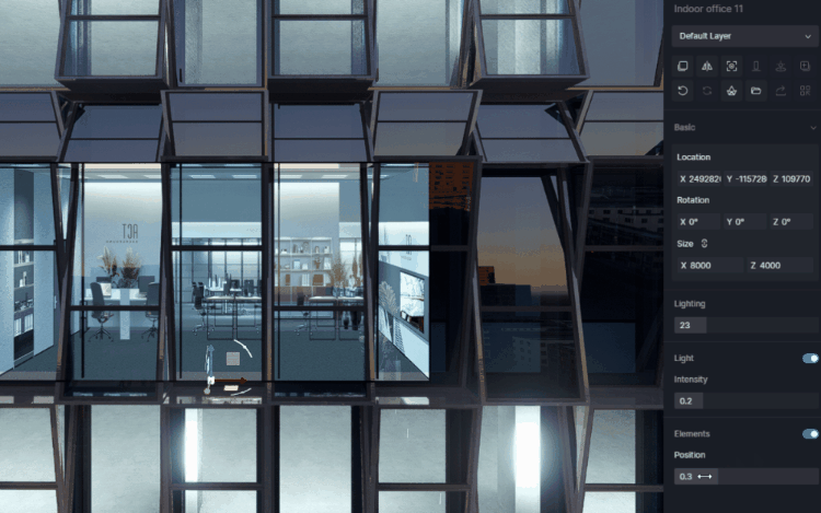

Not only can you scale the assets, several other parameters are also enabled:
Lighting, controls the overall lighting of the assetLight, an option to switch on/off lights in the interior parallax. Intensity is also enabled to adjust the luminance for all the light sources.Elements, an option to keep/remove necessary components like furniture into the Interior Parallax
Position, controls where the component is placed, whether near the camera or away from the camera.
