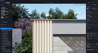

Use high-quality materials
Cameras close enough to the facade can tell a lot about the materials/textures you apply for the models. Using textures from D5 with high-resolution material maps, preset adaptive parameters, your facade will be even more realistic and stunning.
D5's round corner and one-click thickness simulation features are also super convenient.
For skyscrapers/buildings with glass façade, the free Blue Curtain Wall Glass material from D5 Asset Library is highly recommended.
Apart from that, aluminum plate, rough concrete, landscape textures, and diverse wall bricks are also included in D5 Material Library.
A lot of free downloadable 4k-textured materials are available, so you can effortlessly make a realistic facade rendering with D5 Render.
