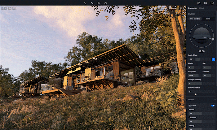

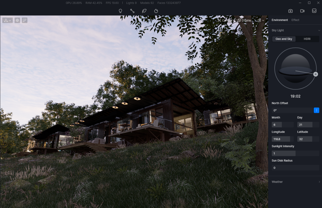

Geo&Sky is especially helpful when you want to create a twilight scene like this:

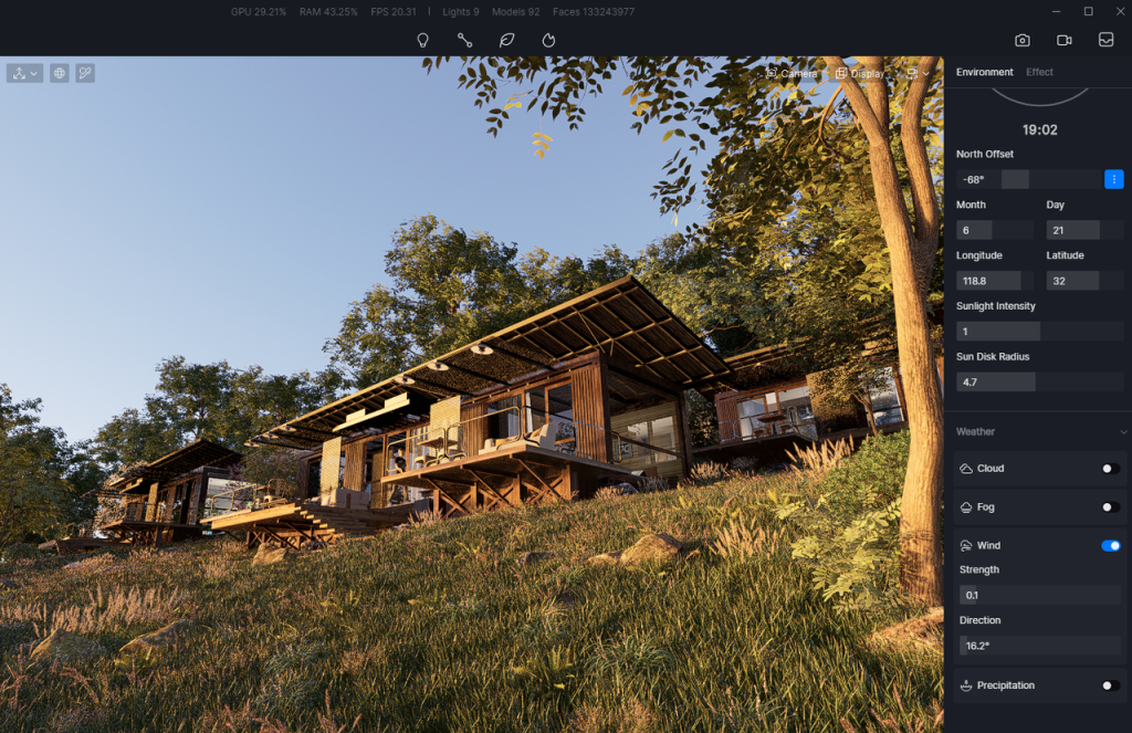

Set the time to evening, which ensures correct color temperature and shadow length.
Then adjust North Offset, making sure the building's main facade faces the sun, so that it can be properly illuminated.

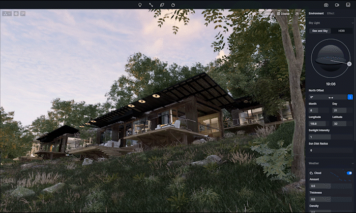

Here is an example of how NOT to set the sun. When the sun is on the side of the building, we can see that the whole building is shrouded in shadow, thus losing many details and looking blurry.

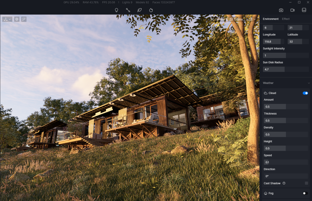

In order to create a relaxing and cozy vibe for this twilight scene, we can pull the Sun Disk Radius higher, making the shadow edge as soft as possible. This step can prevent confusion between twilight and noon. To add a tint of romance, you can turn on clouds which will look pink and purple under the influence of sunlight.
Now you can see how Geo&Sky has improved the quality of the whole image.
