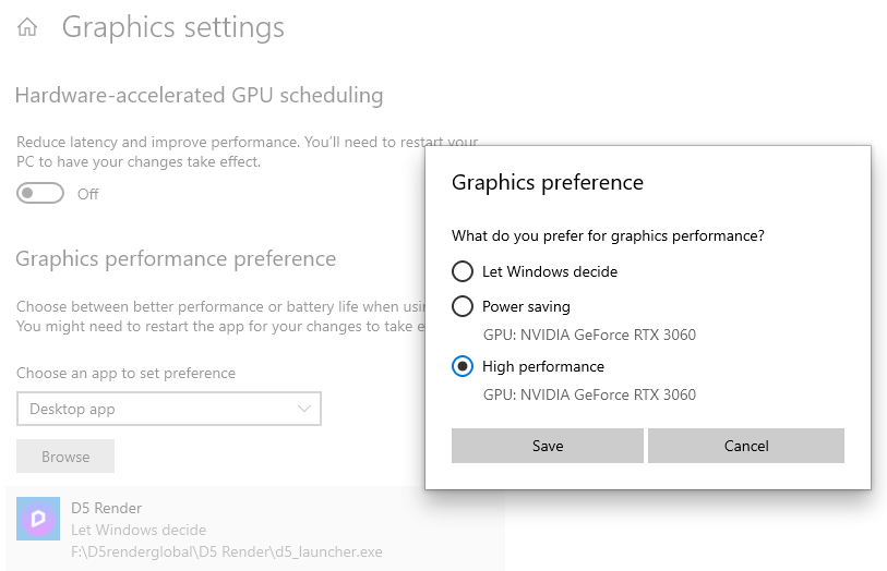

2. Starting from Windows 10 version 2004, a feature called “Hardware-accelerated GPU scheduling” has been introduced. It is not recommended to turn it on for D5 Render, since D5 has its own algorithm to make use of the hardware efficiently and stably. If it is already turned on,  please select High performance mode for D5 Render.
