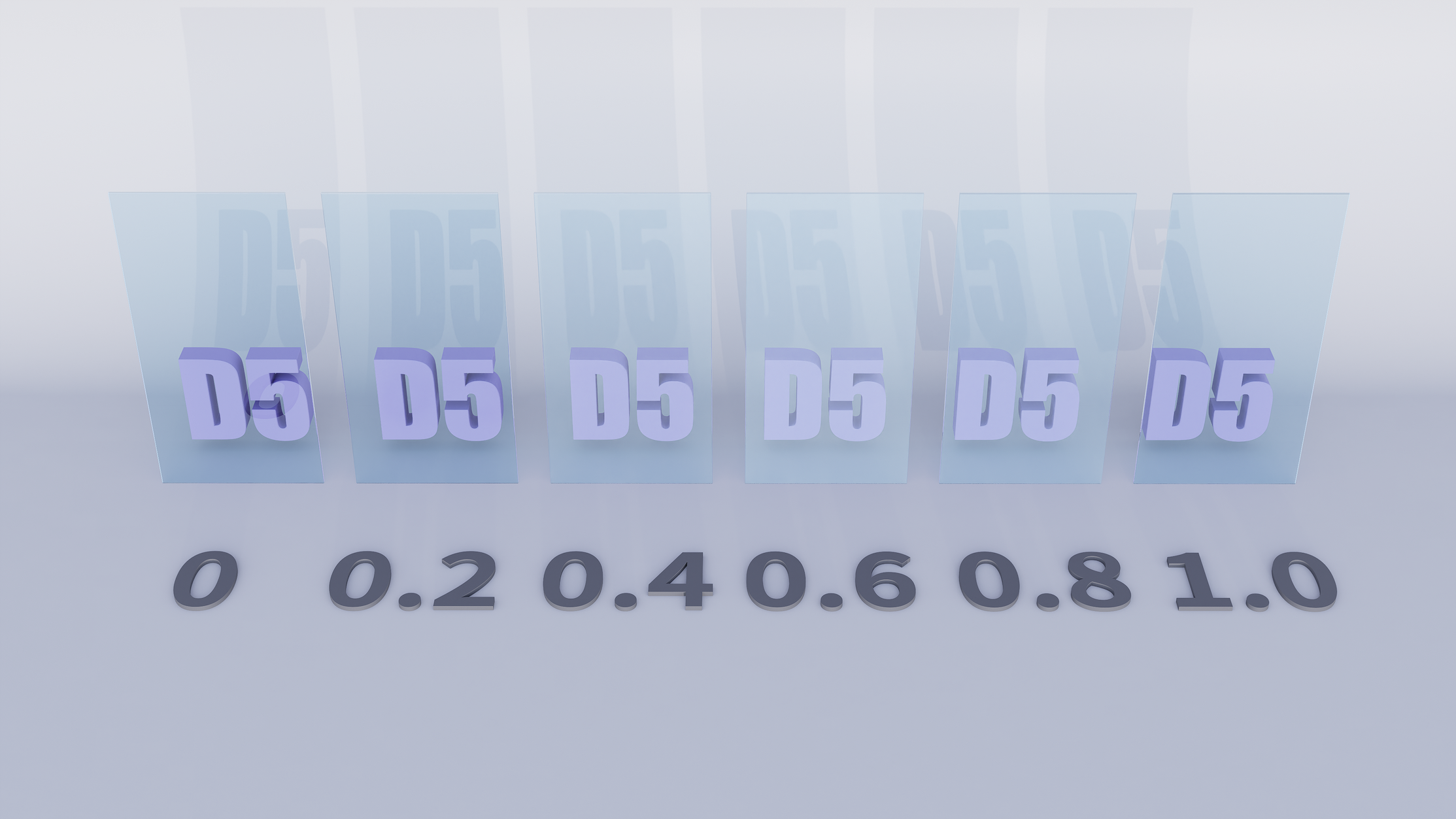

Thickness

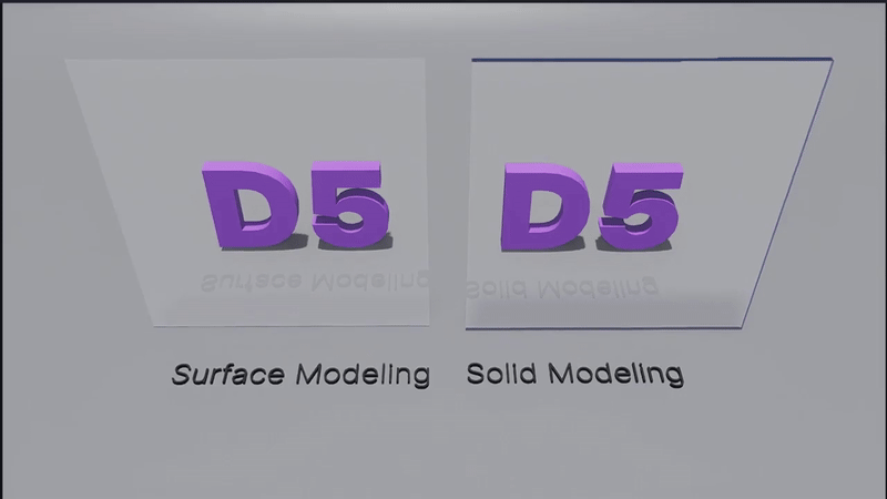

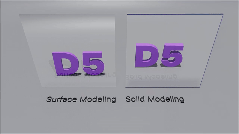

Basically, there are two ways of modeling: one is solid-modeling, which means building models in a geometrically correct way; the other is surface-modeling with only visible facets in order to keep the model file light.
When glass materials are applied onto the latter, they may have incorrect refractions. To fix this, you don’t need to model in DCC software again. Turn on the “Thickness” option in D5 Render instead. The glass will immediately have a correct refraction, which is quite convenient.

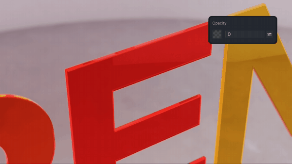

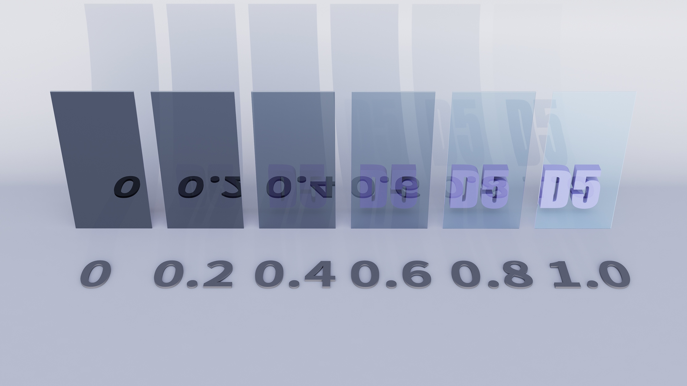

Transparency
By adjusting Transparency, you can decide how much light can pass through the glass material.
Achieve stunning effects like colored gradient glass by enabling the ‘Affected by Light’ option. Adjusting the opacity value and using black-and-white maps to control the opacity pattern allows for dynamic light interaction.

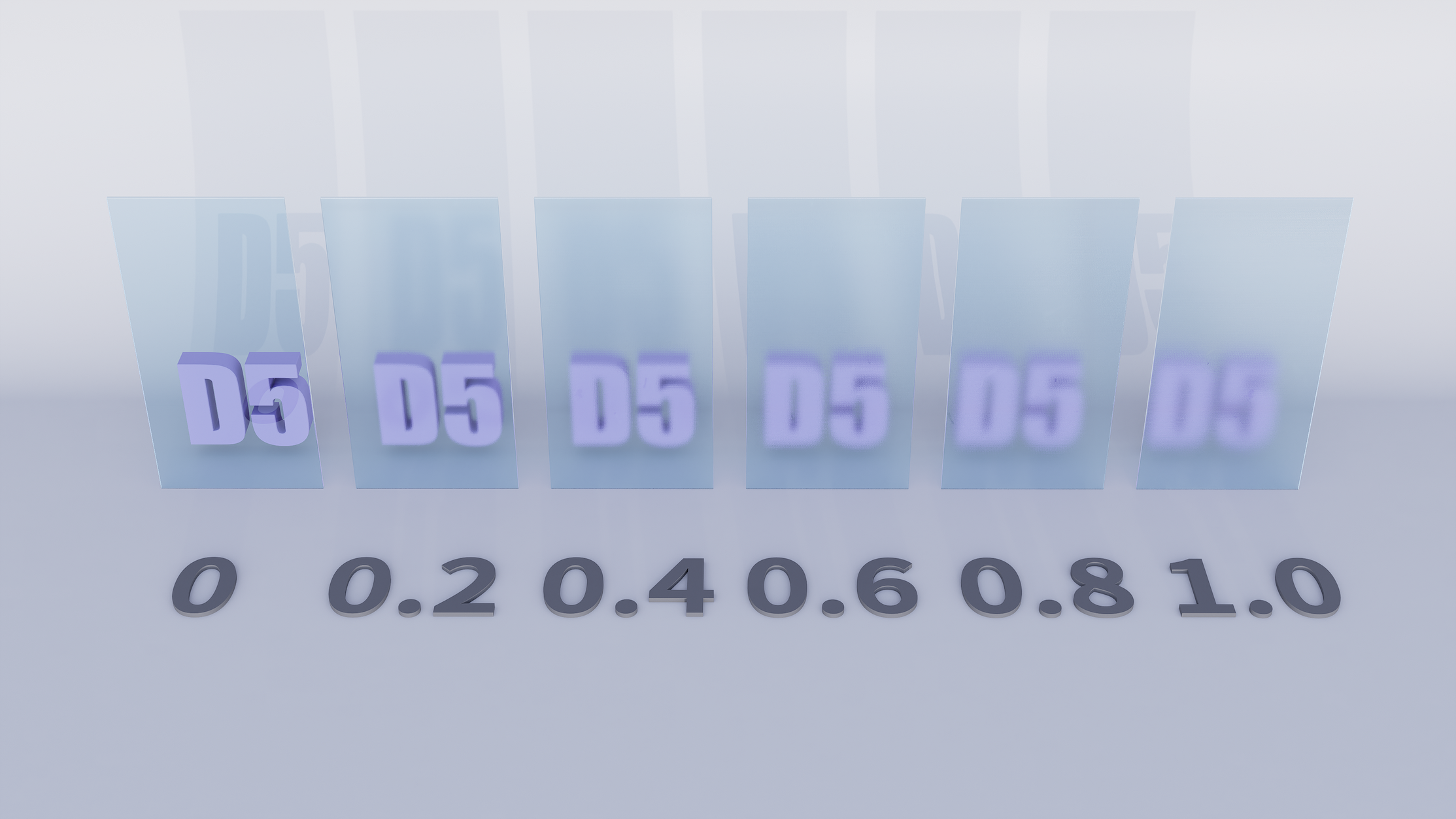

Roughness
It controls how smooth the glass surface is.
For now, the effect of frosted glass made with Roughness may not be evident. So we’ll introduce a method of making it in the later part of “how to make frosted glass”.

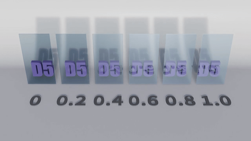

Specular
The Specular parameter influences how much light will be reflected by the glass material.

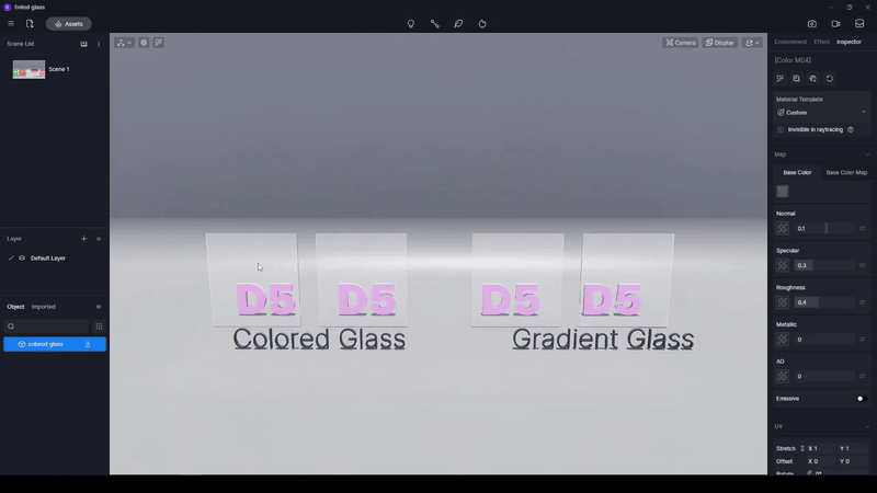

Color
You can create solid-colored glasses by changing the base color, or gradient-colored glasses with a map.

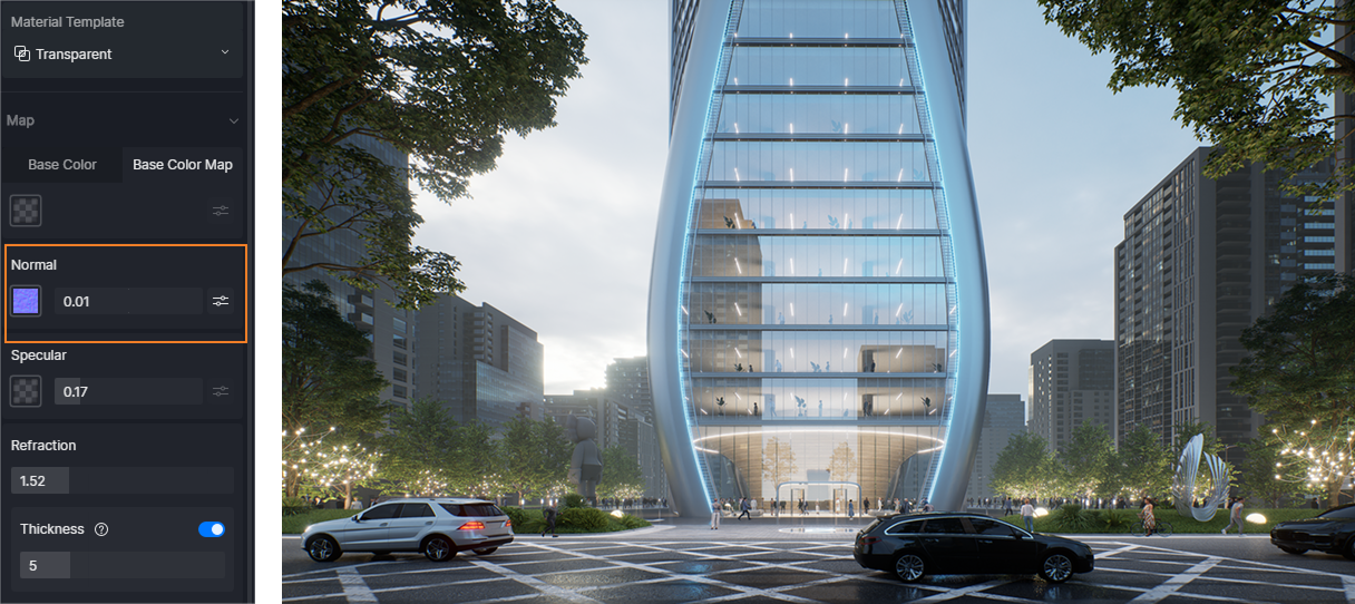

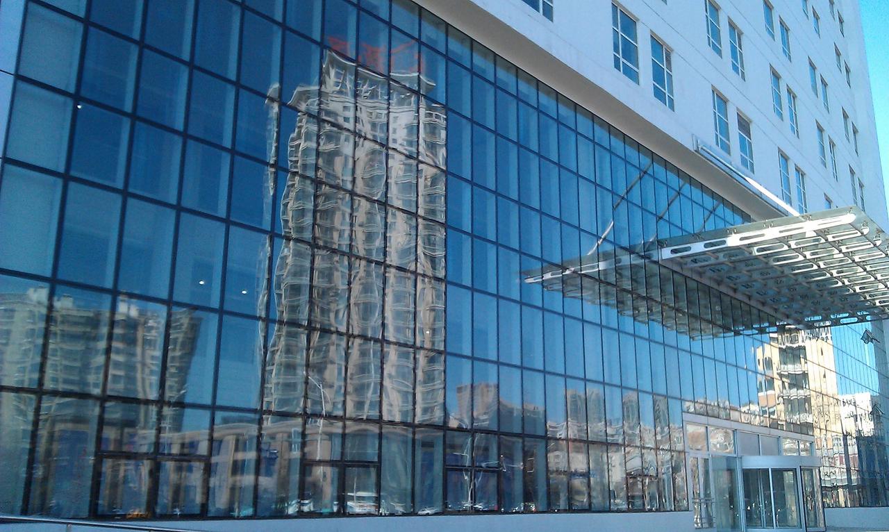

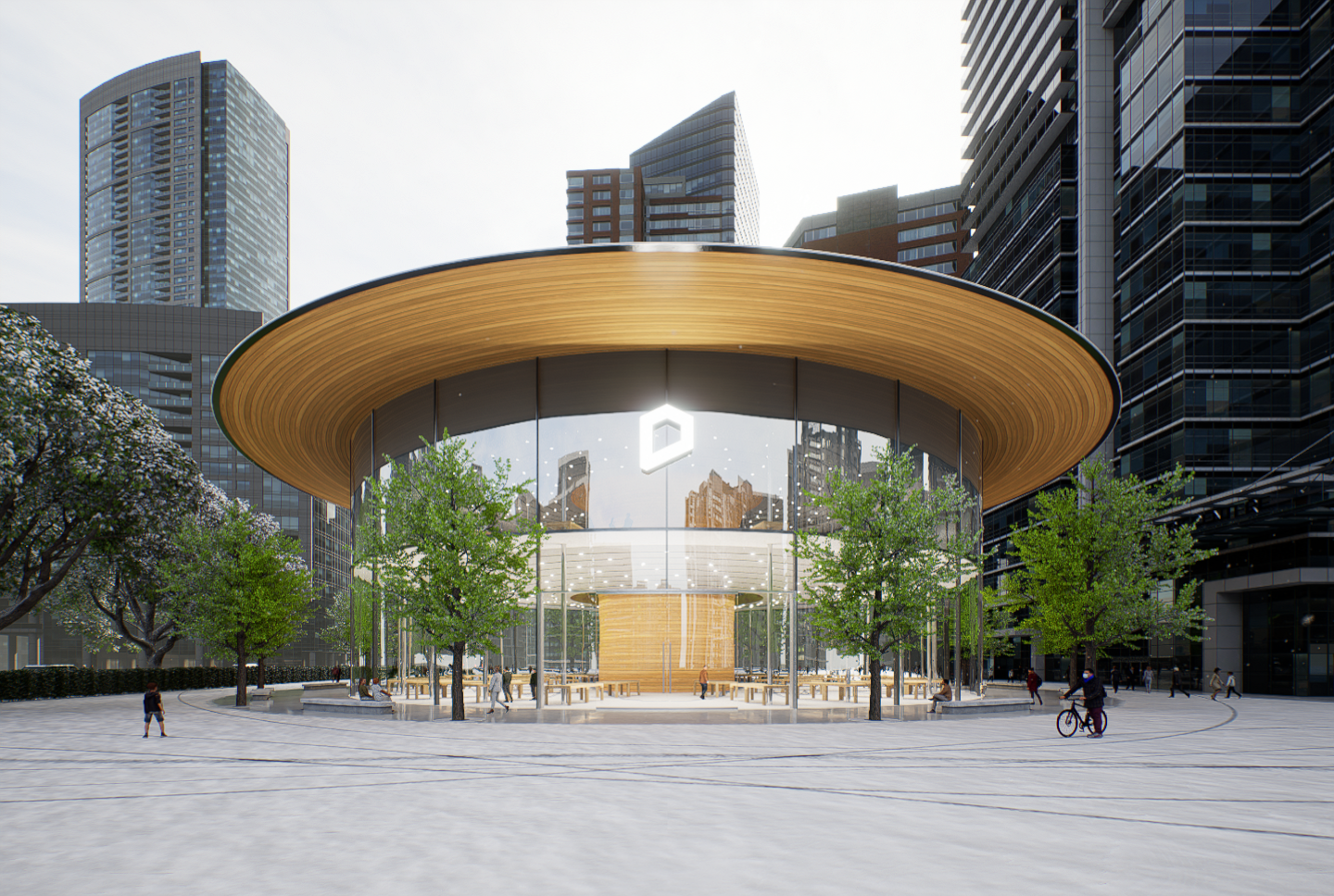

Observing the glass facades in the real world, we can see that they have a reflection looking like waves. That’s because glasses usually have slight bumps on their surface due to the processing technology.
So, how to achieve this effect?

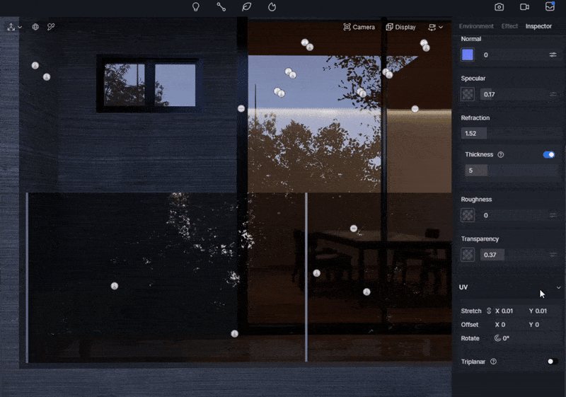

You just need one Normal map.

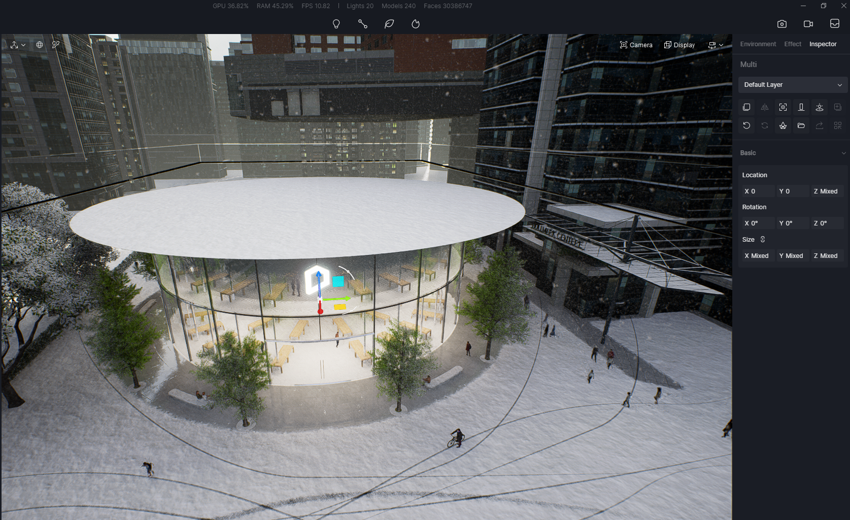

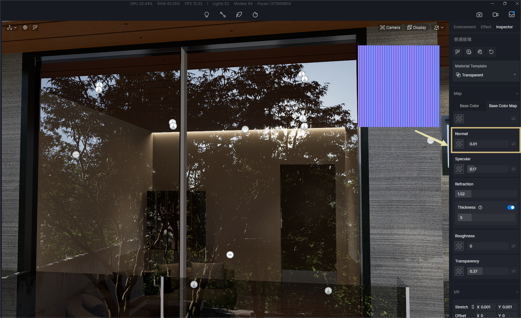

Take this building for example. To simulate those wavy reflections in glass, you just need to import a Normal map, reduce its UV value, and increase the Normal Intensity a bit.

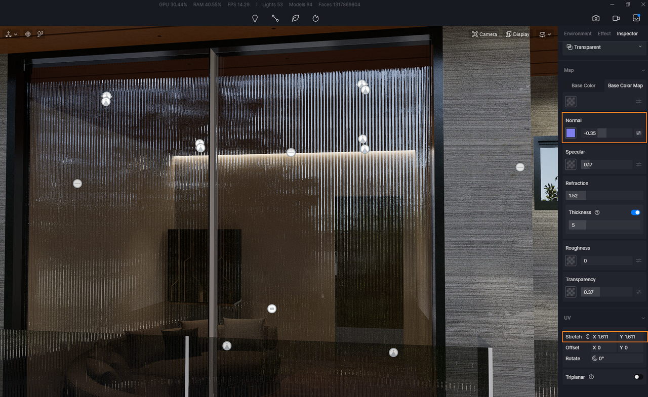

A normal map can also play magic when you want to make fluted glasses.
These tiny changes could be the finishing touch on your scene.

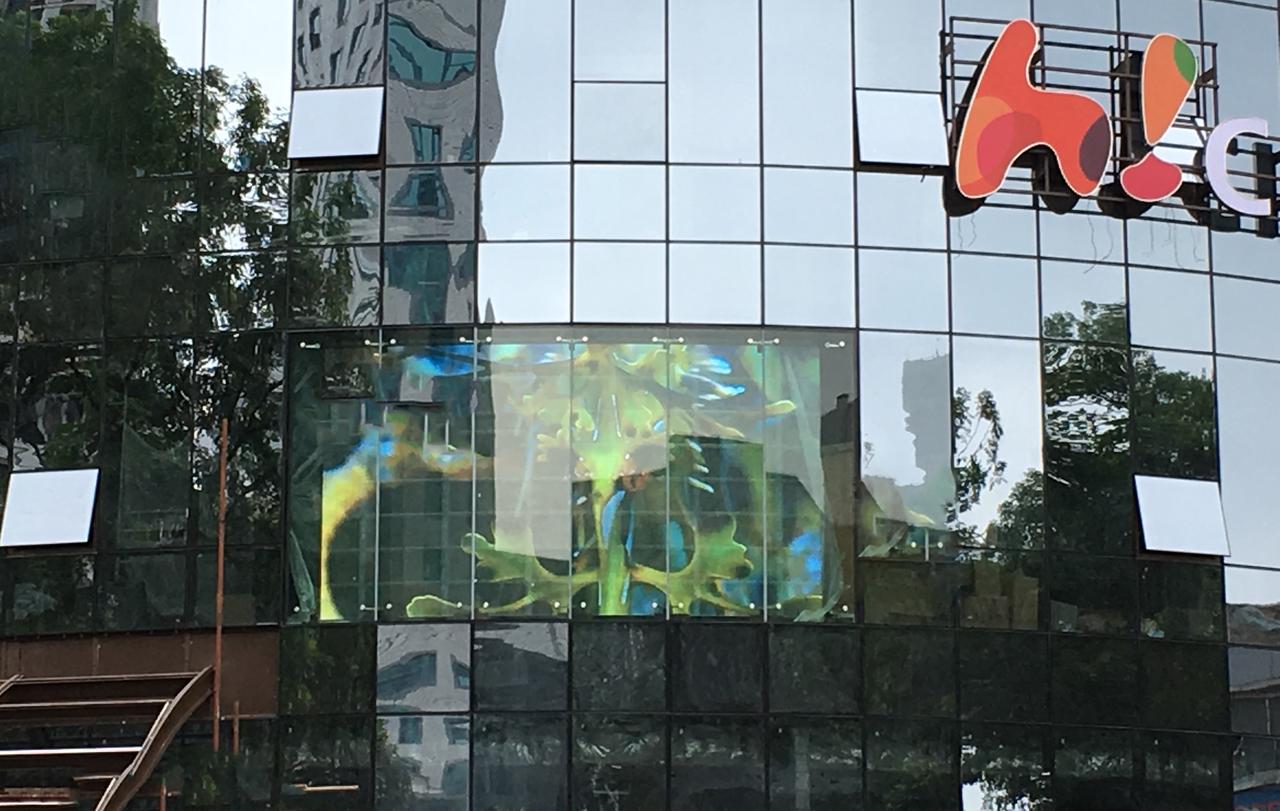

How to make black-tinted glass

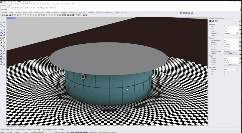

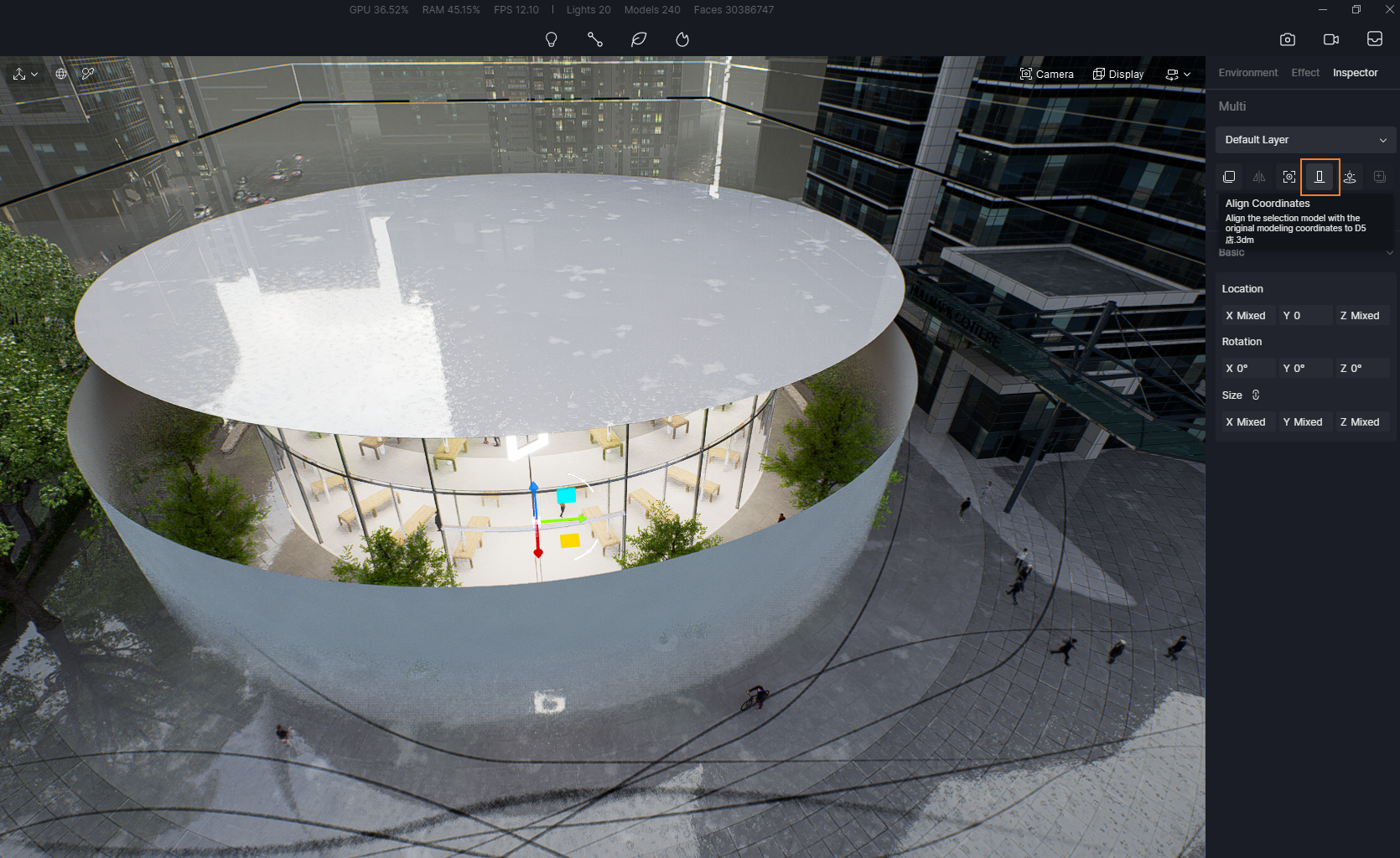

Actually, it’s quite easy to make a gradient glass facade as shown above.

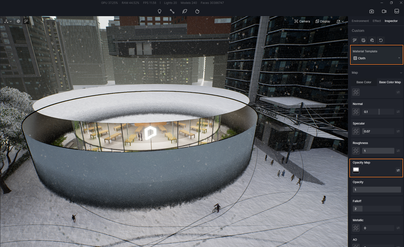

First offset the surface of the facade model. Change the material of the offset surface to Custom with a black-to-white normal map.
After importing it into D5 Render, you can give the offset surface the texture of Cloth. Then add a black-to-white gradient map into the Opacity column. Align the surface model and the facade model.

Here’s a trick to make frosted glass in D5 Render:

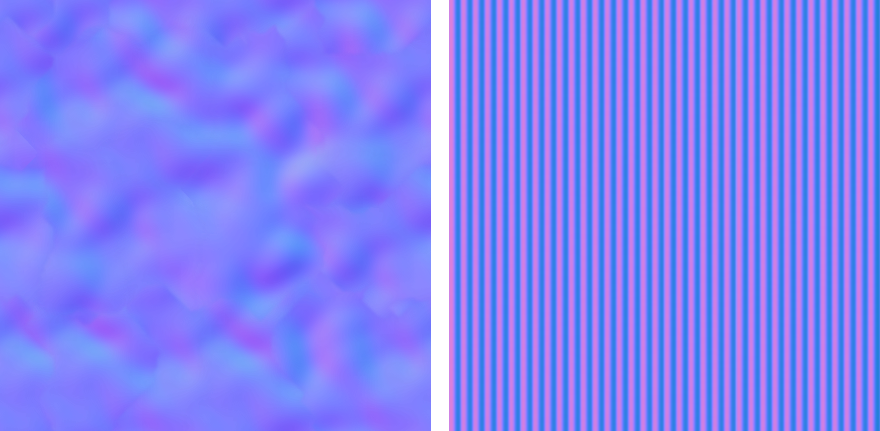

Add a Normal map, stretch its UV and turn up the intensity.
Done! That’s all you need to do.
Here’s the Normal map we used in the article:
