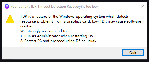

Most graphics software users have probably seen a notification at some point warning that their computer’s TDR delay value is too low. This notification is also likely to appear when rendering high-resolution images or videos in D5 Render.
What is TDR
To resolve this issue and ensure a good D5 Render experience , follow these steps to increase the TDR recovery value:

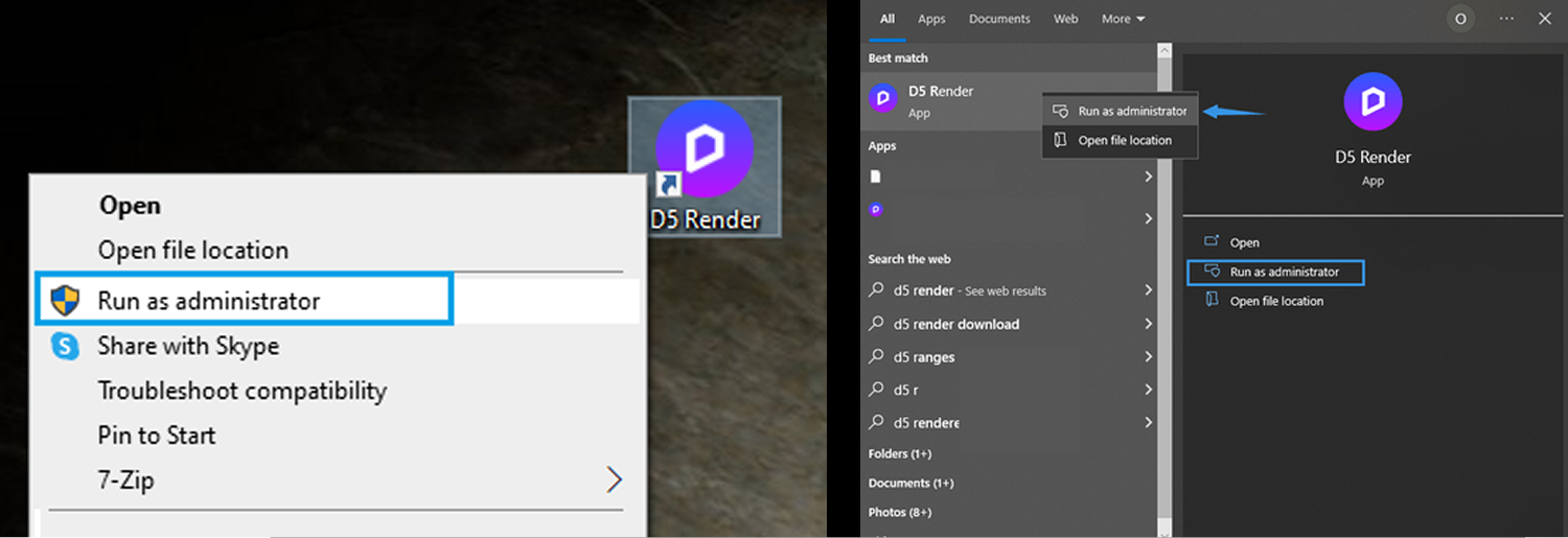

1. Close D5 Render and look for its shortcut on your desktop or in the Windows start menu.
2. Right-click on it and choose Run as administrator.
Please note that this action requires administrator permission for your Windows account. If you are not an administrator, please switch to the administrator account or contact your company’s IT department.
3. When the D5 Render welcome page appears, wait about 5 seconds, close D5 Render, and restart your computer . Now you don’t have to worry about TDR crashes anymore.

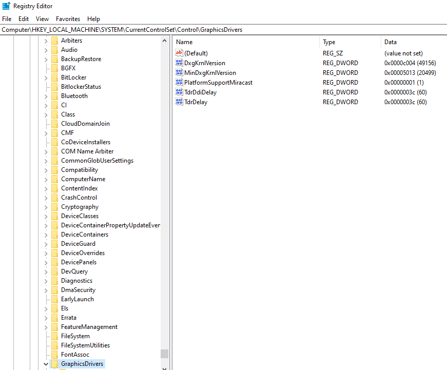

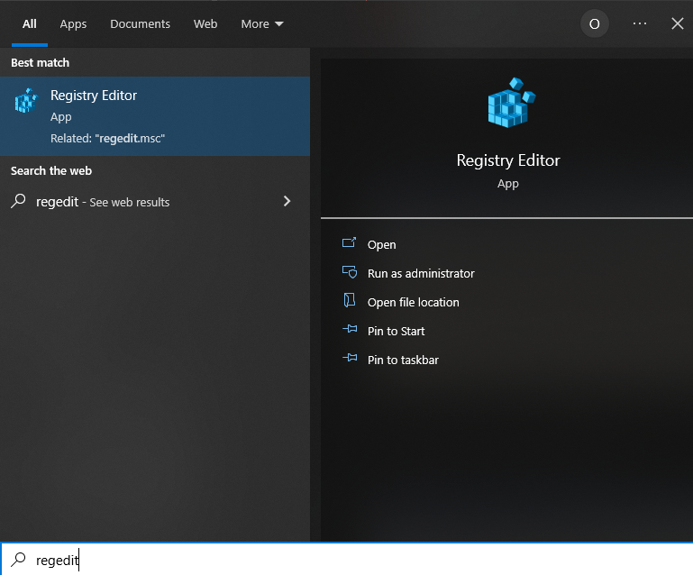

1. Open the registry editor of your Windows system (administrator permission is required)
How to manually control the TDR value
2. Navigate to this key:
Computer\ HKEY_LOCAL_MACHINE\ SYSTEM\ CurrentControlSet\ Control\ GraphicsDrivers

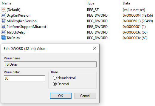

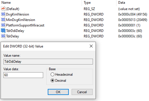

3. Add or edit the TdrDelay value
Right click on the TDRDelay key > Modify, then change to decimal and enter the value data as 60.

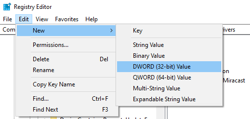

If the TDR Delay key doesn’t exist, create a new one via Edit > New > DWORD (32-bit) Value . Name it “ TDR Delay .”
4. Add or edit the tdrddiDelay value
Do the same as in step 3 for TDRDDI Delay value.
