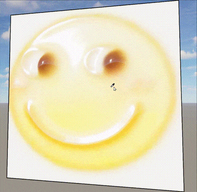

Take this emoji for example.

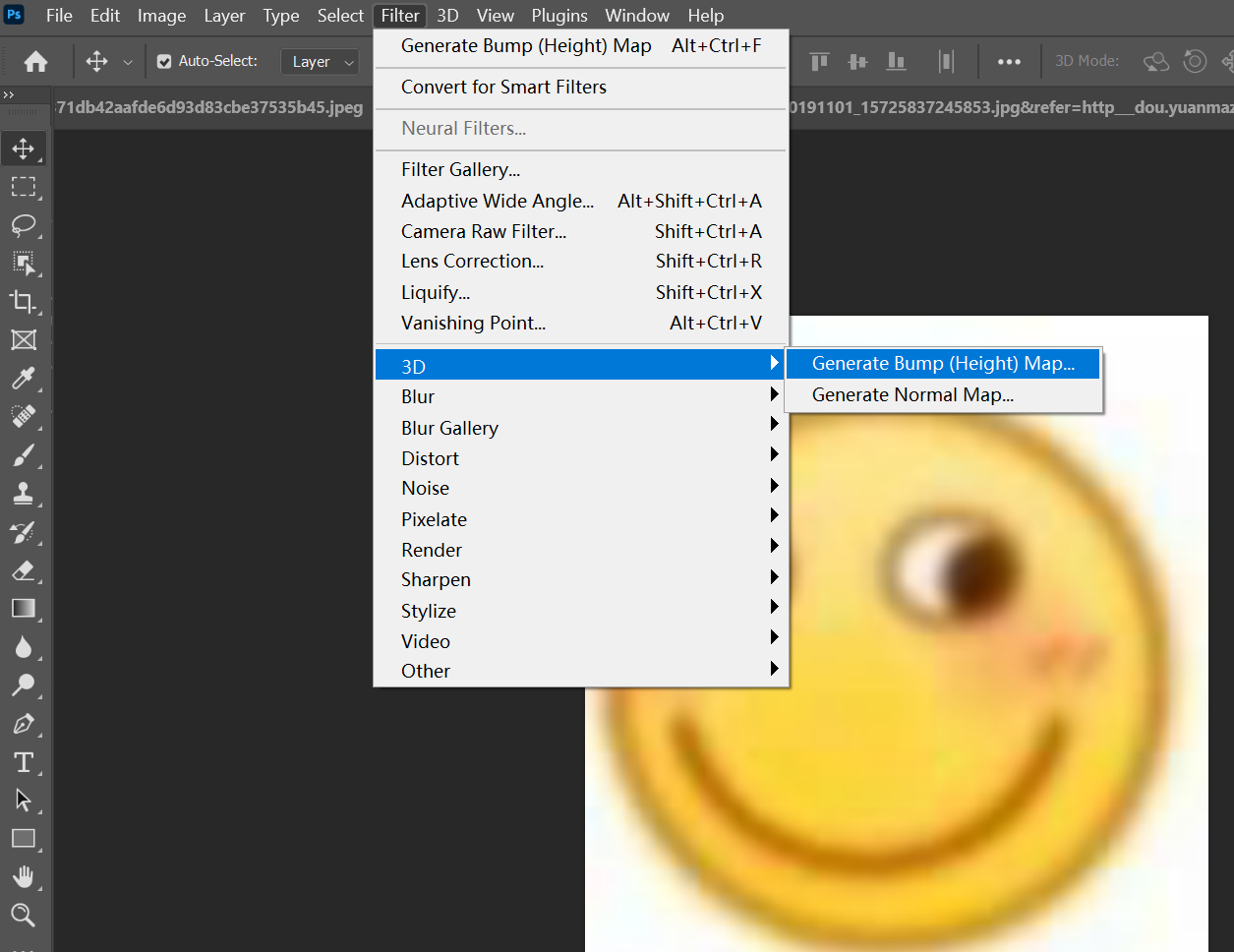

First, open the image on which you want bumps in Photoshop. Choose Filter > 3D > Generate Bump (Height) Map.

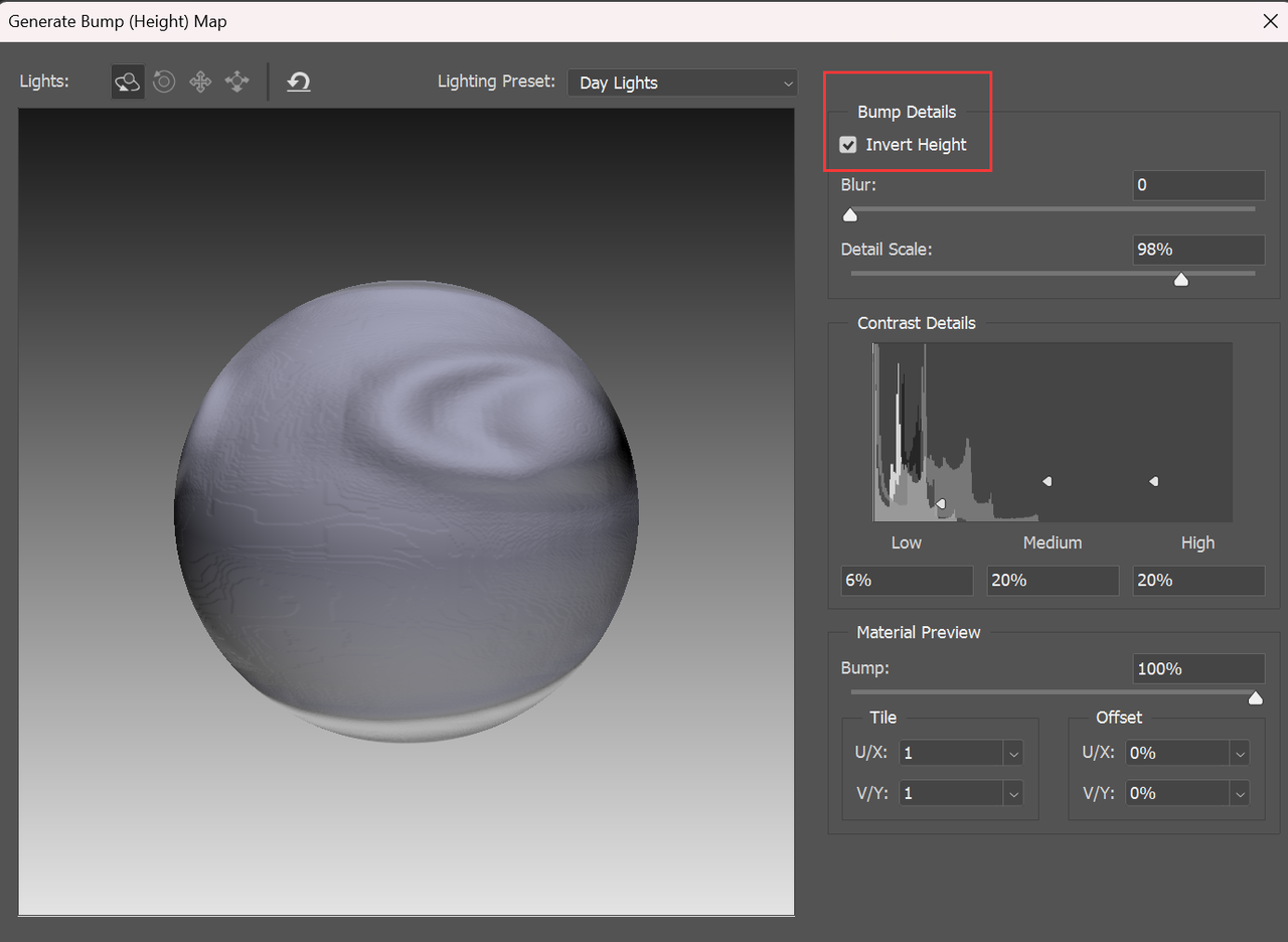

Adjust the parameters in the pop-up window according to your need, and you can see the change in the left window.
Before getting down to making the map, you need to understand the logic here: the whiter the area, the more it bulges.

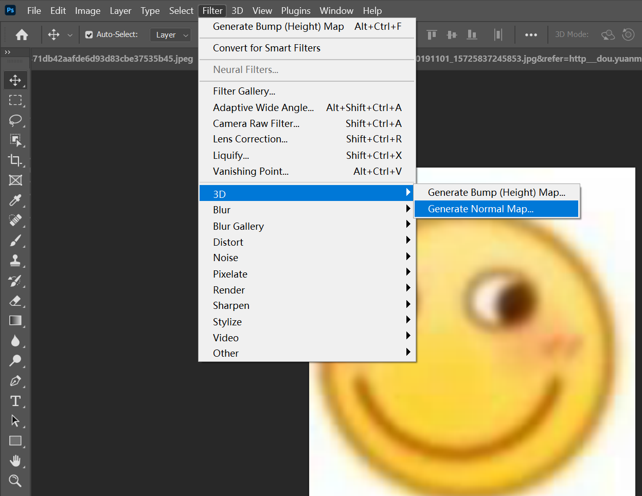

Then go to Filter > 3D > Generate Normal Map (generally speaking, the default parameters do not need to be modified) to create a normal map for it.

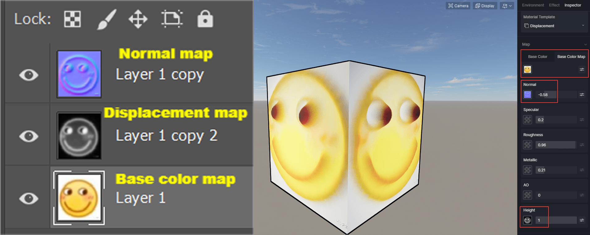

Now we have three texture maps:Normal map which controls how bumps and dents reflect light;Displacement map which simulates model bumps and dents;Base color map. Export them as .png files.
In D5 Render, select a material and then change it into the Displacement template.Put the three texture maps into the corresponding slots.
We can see that the displacement effect looks realistic with appropriate light reflection.
