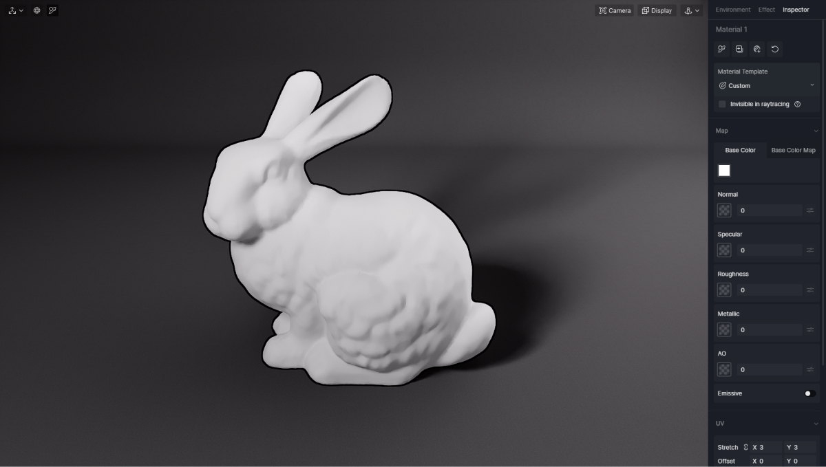

Initial look
This rabbit has a custom material with a white base color. We set Specular and Roughness to 0, so they won't affect the following process.
What's real-time Subsurface Scattering and why you need it
