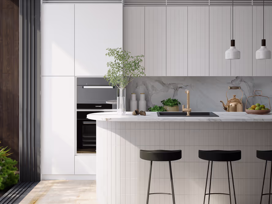

When it comes to SketchUp real-time 3d rendering, D5 Converter could be the best livesync plugin for you to work with. You'll not only enjoy the convenience of model/material/light/camera synchronization, but also benefit from the powerful rendering software, D5 Render.
This article is a guide on how to speed up your SU to D5 workflow with tips and tricks to help you make better scenes with ease. This interior kitchen rendering by Quoc Phan will be used as demo scene.
