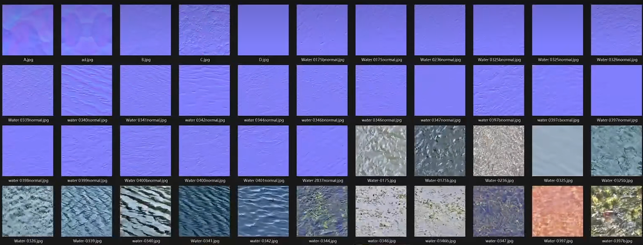

- The Normal map decides the appearance of ripples or waves. You can change how strong the wave is by adjusting its intensity and how dense it is by adjusting UV. These parameters play a key role in affecting whether the water texture looks realistic or not.

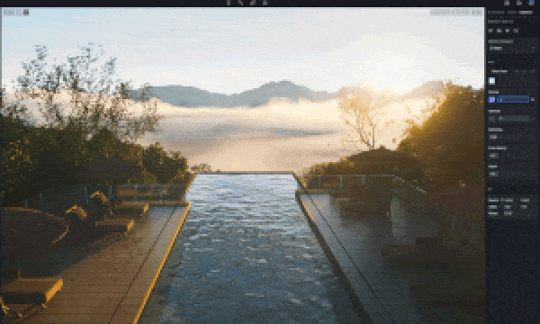

How to render a swimming pool with clear water
After changing the material template to "Water", you will find that the water texture seems out of tune with the soothing morning vibe we want to create, thus needing further adjustments.

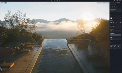

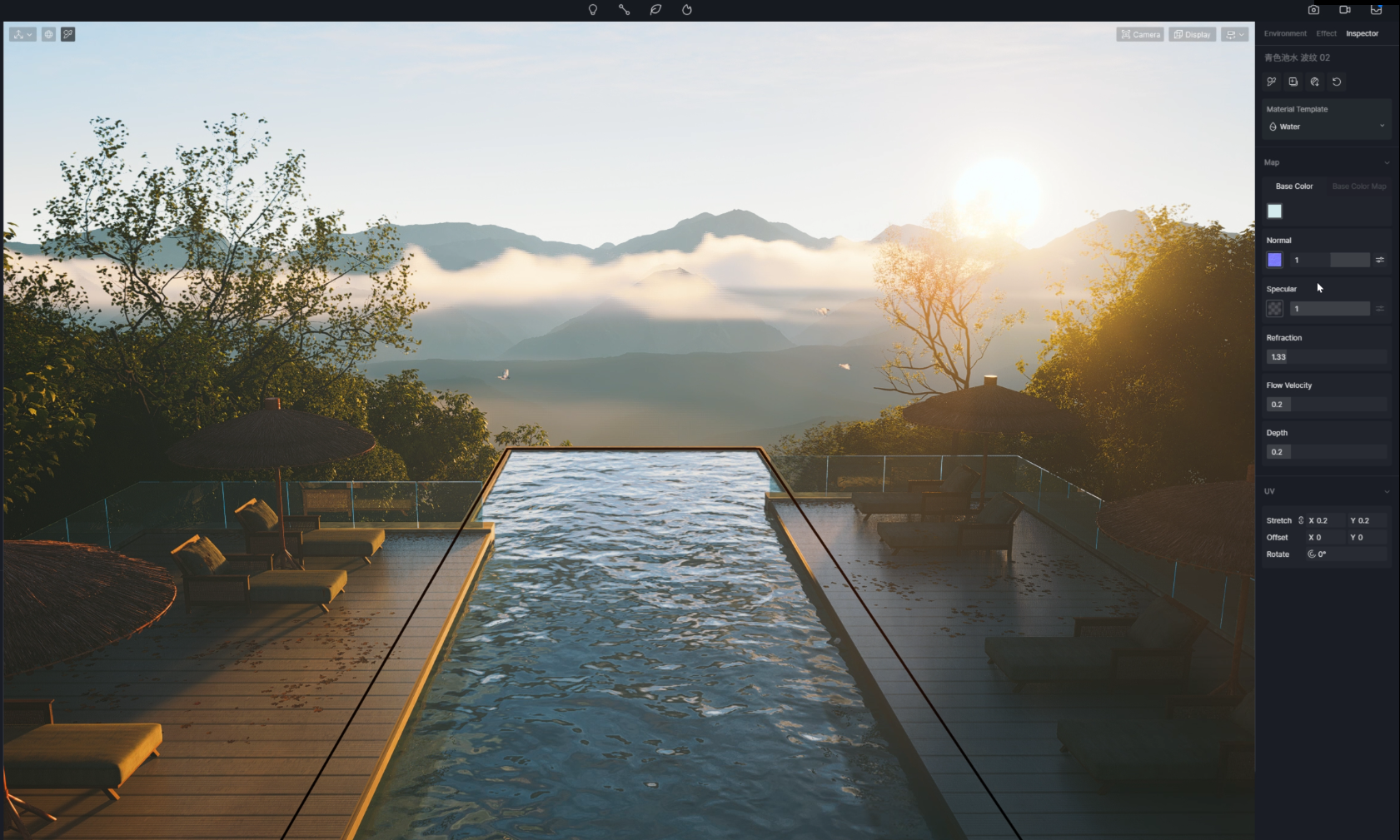

Step1: Adjust the overall look of water waves
After importing a proper Normal map, you will see that the present water texture still looks rough and bright, more like sea. That's because you need to turn down the Normal intensity and Specular a bit. Now the waves become gentler and milder.
Step 2: Further improvements on the details of water texture
As we have mentioned above, 1.33 is an ideal value for water refraction as it tends to give results close to the real world. So there's no need to change the default Refraction setting.Now there's only one step left to create realistic water texture for this scene: reducing the flow rate by lowering Flow Velocity.
Now it's all set.

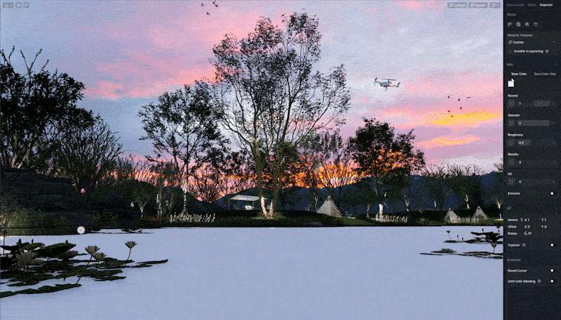

How to render a lake with deep water
First thing first, change the material template to "Water".
Step 1

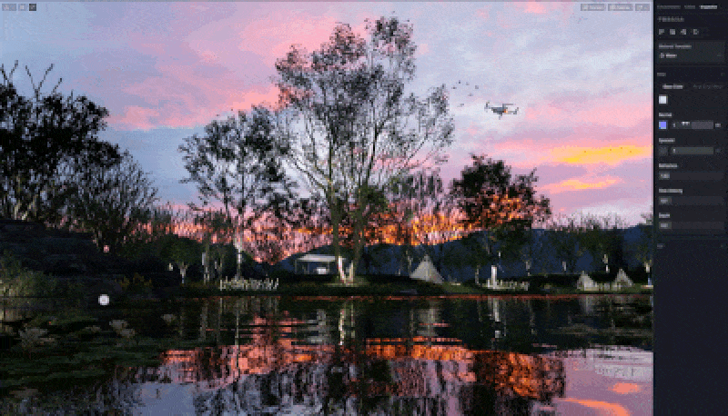

Similar to what you have done before, import a Normal map and adjust its intensity as you need.In this lovely sunset scene, if you want to see a clear reflection of the surroundings on the water surface, try to set specular to maximum.

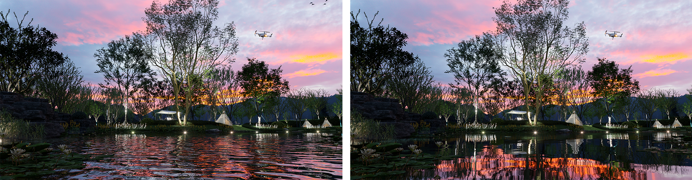

Step 2
Think about the lake or sea at dusk. It's usually hard to see through the water surface what's underneath. So you need to pull the Depth slider to the right. When the Depth value is low, the lake will look shallow and unnatural.
Now you can see the change of atmosphere before and after the adjustment.
