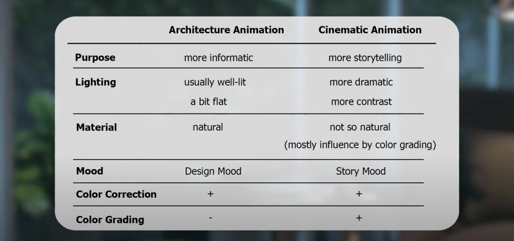

  • The contrast between architecture animation and cinematic animation
Full guide on how to make cinematic animation in D5 Render
In a word, imagine you are the one who is in the scene. Focus on how you feel, instead of what the room looks like. Then create the atmosphere around your feelings.

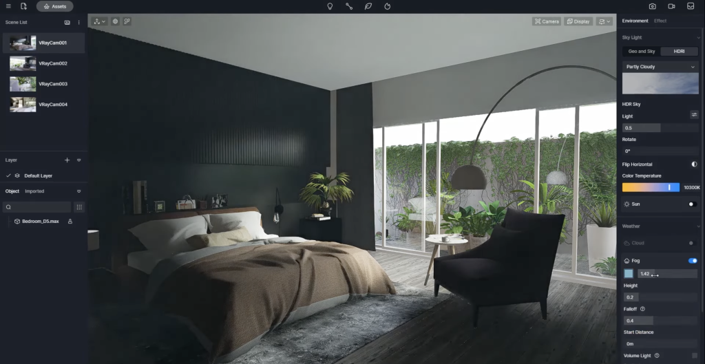

1. Set the environment
Here Aung used HDRI "Partly Cloudy" with a cold tone, as well as Fog with a tint of blue, making the room look hazy and dark on a rainy day.

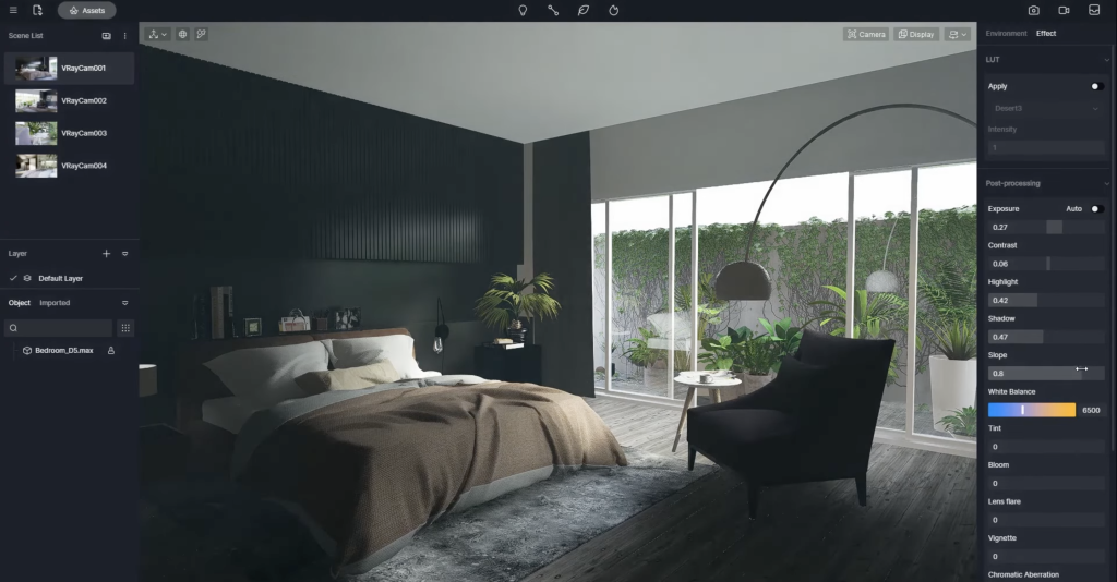

2. Adjust Highlight and Contrast
This means color correction and grading at the same time in the post-processing panel. Aung also turned on Bloom to make the outside shine a bit more. The built-in LUT "Desert" helped a lot as well.

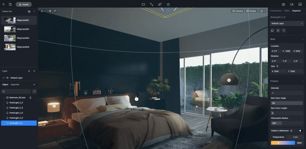

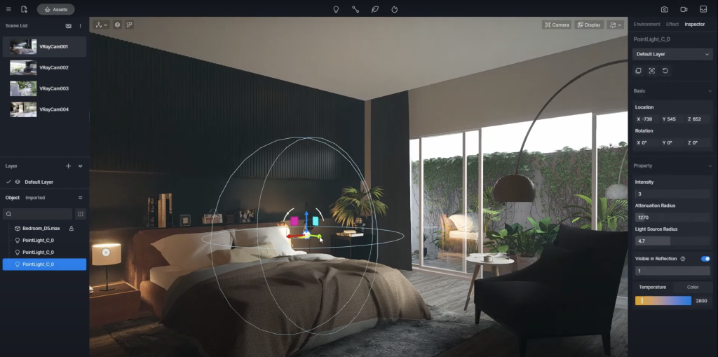

3. Adding accent lighting
Move on to light editing. Aung hoped the room would look cozy for a reading man. So he put a warm yellow Point light in the bedside lamp. Reduce the lighting intensity a bit, and scale down its radius. Now it can light up the area beside the bed.
Duplicate the light and put it into other lamps, such as the one next to the chair.
Check whether the room is just bright for reading. If not, put an area light (rectangular light) on the roof and illuminate the whole space. Low intensity fitting the vibe, don't forget it.

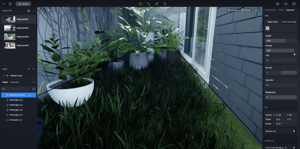

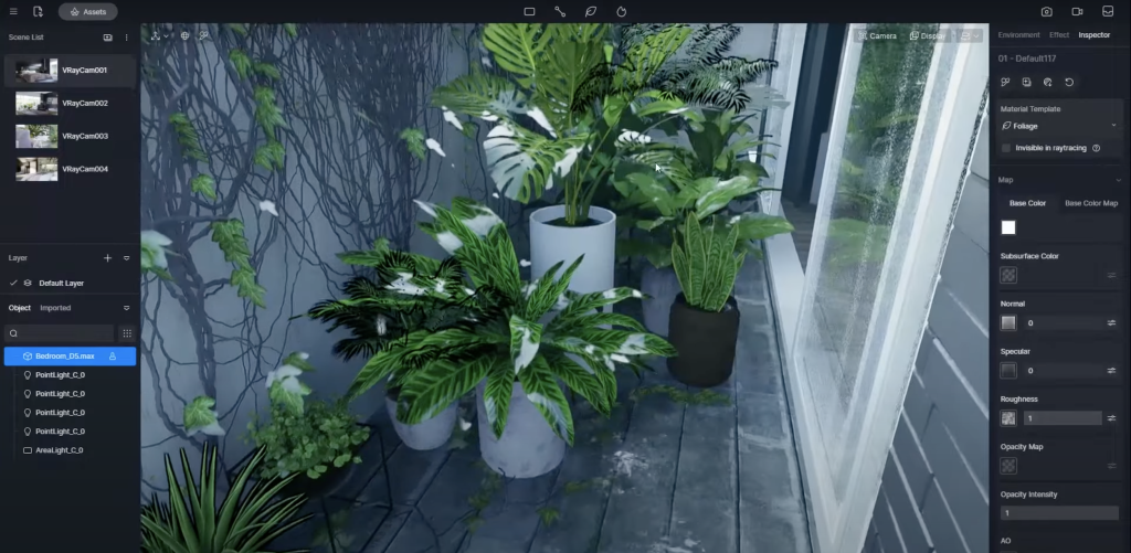

To make the plants on the balcony become more realistic, he changed their material template to Foliage, which gave them a bright, shiny look in the rain.
Then he changed the ground material template to Grass. Adjust the UV, height and density of Grass material to make it more natural.
Done! A lively balcony was born.

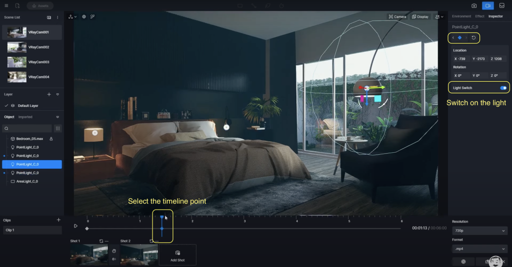

First, Aung defined the start and end points of the camera movement and added two shots to the timeline for them.
Then he set different Depth of Field for the camera shots to achieve a smooth shift of focus. To learn more about how to use DOF for cinematic animation, you can read this article.
To create the effect of lights being turned on, he selected the timeline points when he wanted them to light up and added a keyframe for switching on the light.
Then he made more clips. Add them to render queue for batch rendering and edit them in a video clipping tool.
