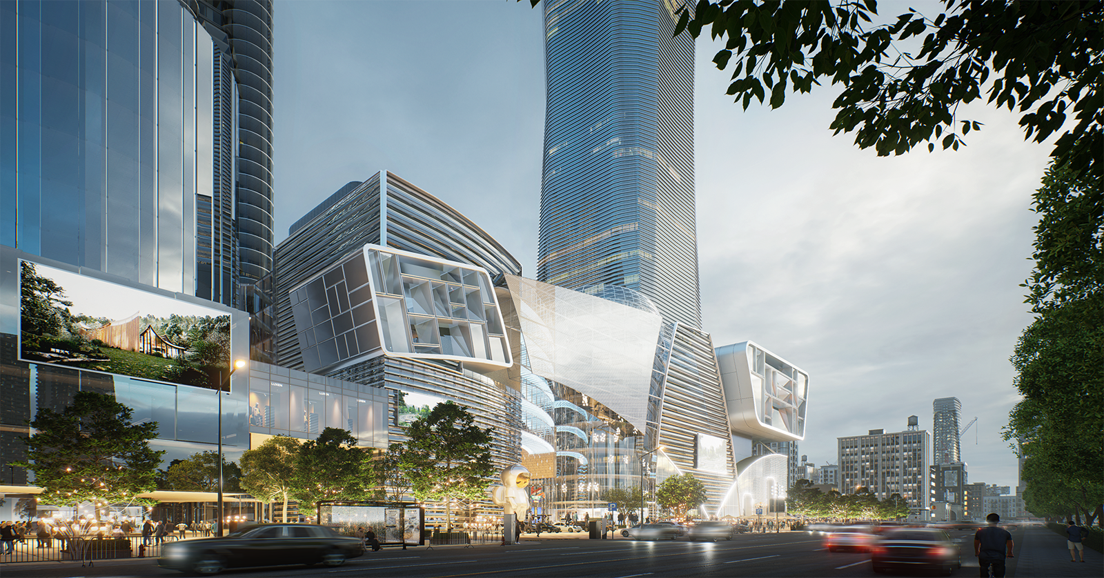

Before Rendered with D5 Render
Archviz Review: Rendering a Commercial Plaza with D5 Render
After Rendered with D5 Render

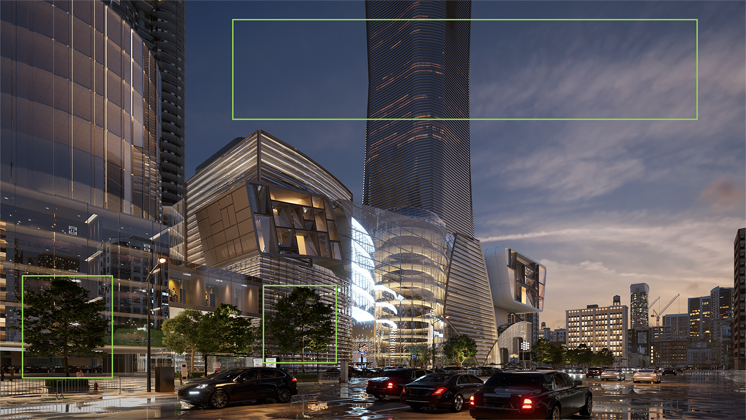

1. Where can it be optimized?

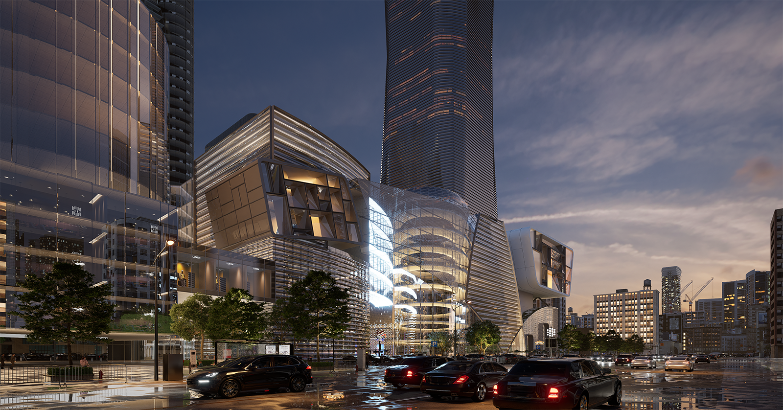

1. The environment seems dim due to the dark HDRI. Thus, the vegetation models look lifeless.

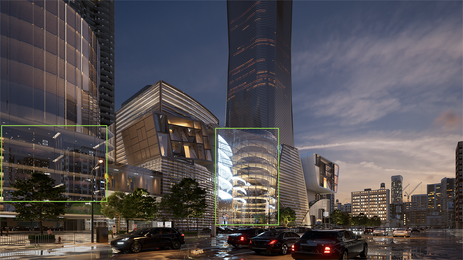

2. The scene looks a bit disordered. The audience's focus will be distracted by those illuminated decorative building models far away. Besides, there are too many water stains on the ground.
3. The reflections in the glass facade can be neater if we change the environment.

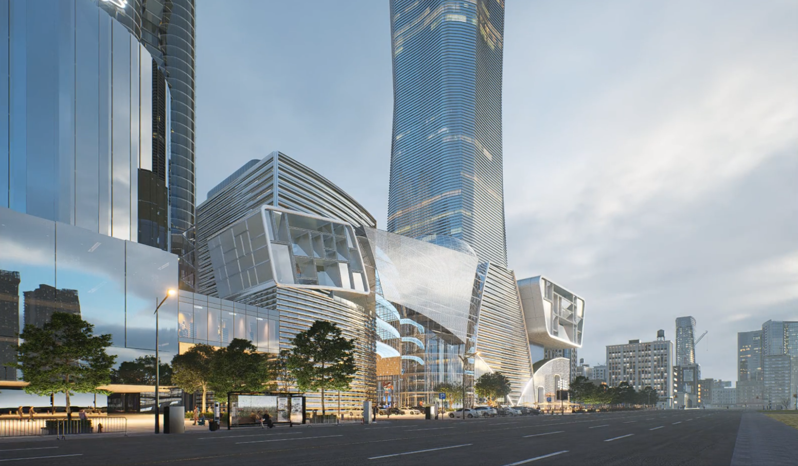

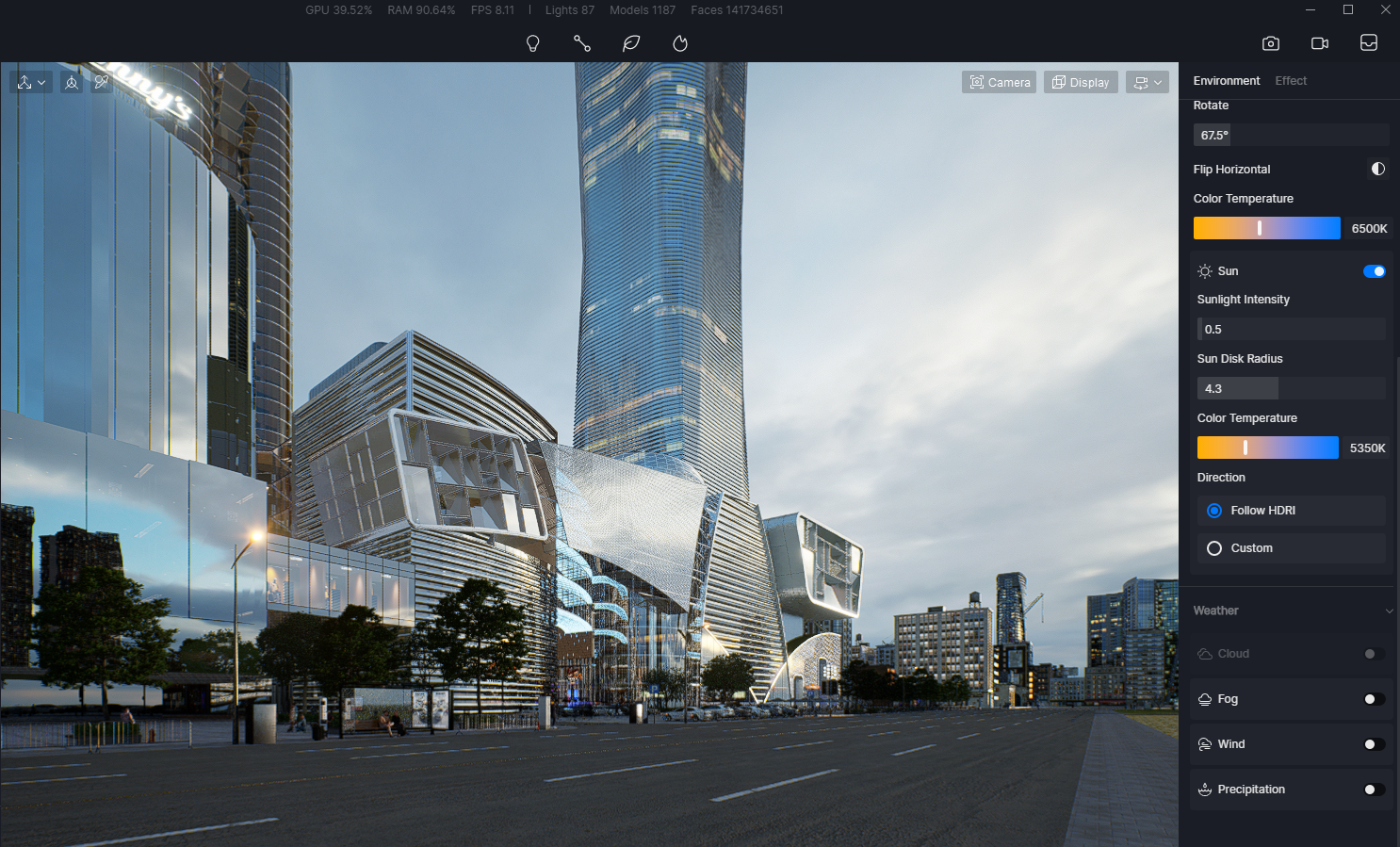

1. Environment and effects

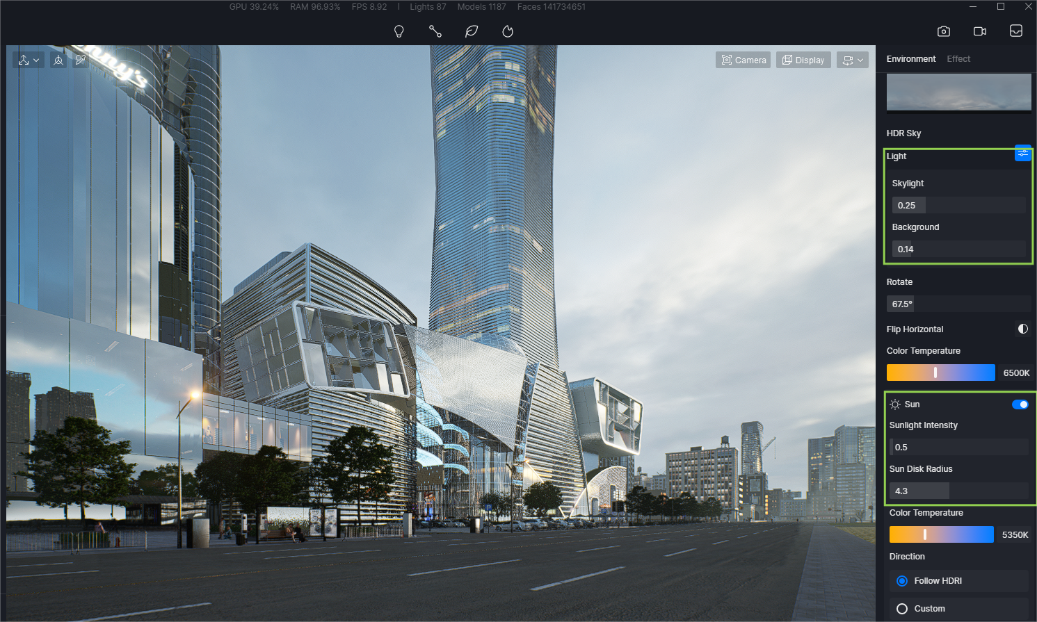

Choose an appropriate HDRI and adjust the light and sun Intensity, making sure the whole environment looks clean.

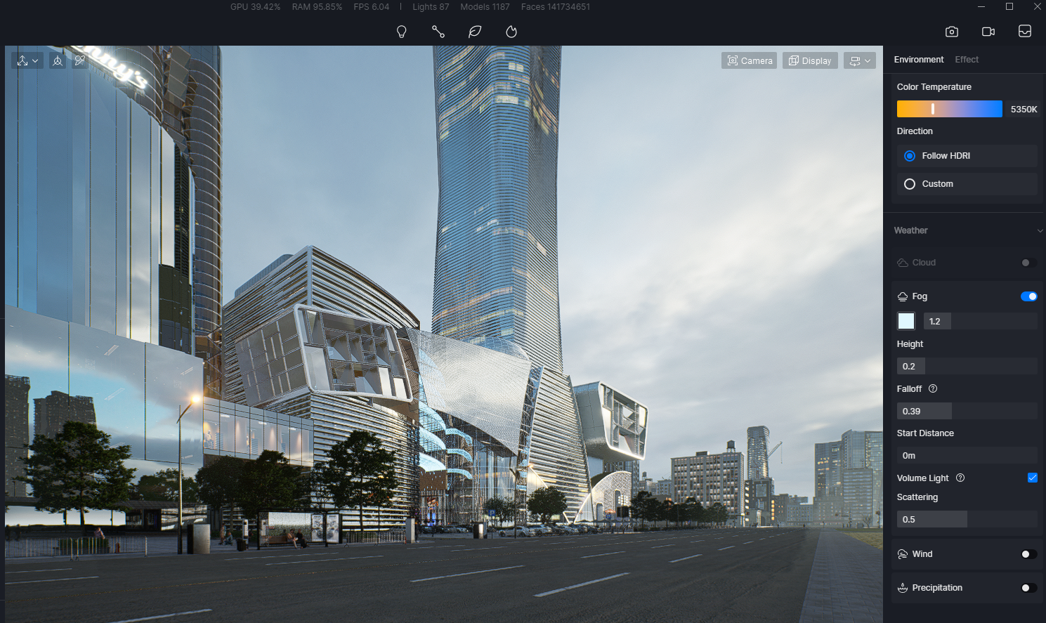

Turn on the Fog effect and make it a bit blue, thus the scene will have a sense of depth.Click here to learn more about how to make full use of Fog effect in D5 Render.

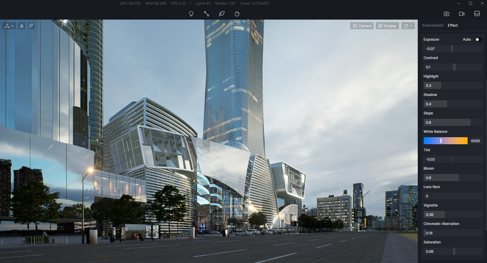

Add some post-processing effects like Exposure, Bloom and Slope as you like.  Keep in mind that too much effects will make the scene look overwhelming. So, a bit of them is enough.

2. Light adjustment

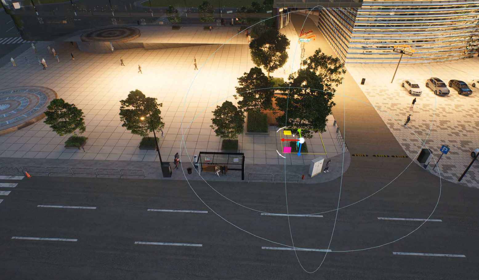

After setting the environment and effects for a general atmosphere, we can see that the scene still looks cold and depressing. That's why we need warm lights to breathe life into this commercial building.

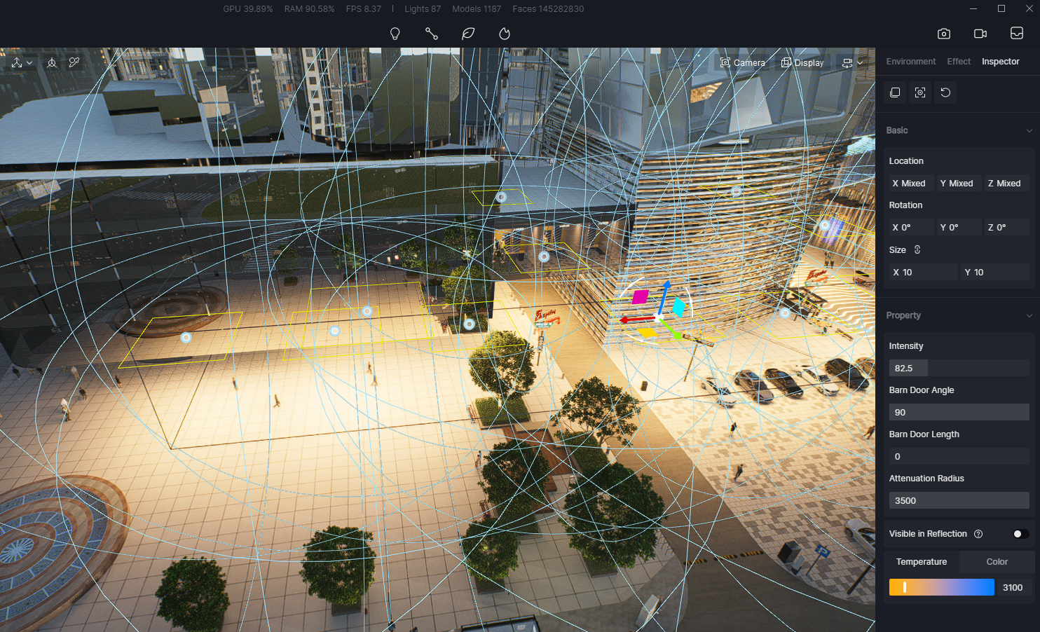

In order to make the plaza more vibrant, we use several warm-tone rectangular lights along the street. Rectangular light is a good choice when we have a large area to light up.

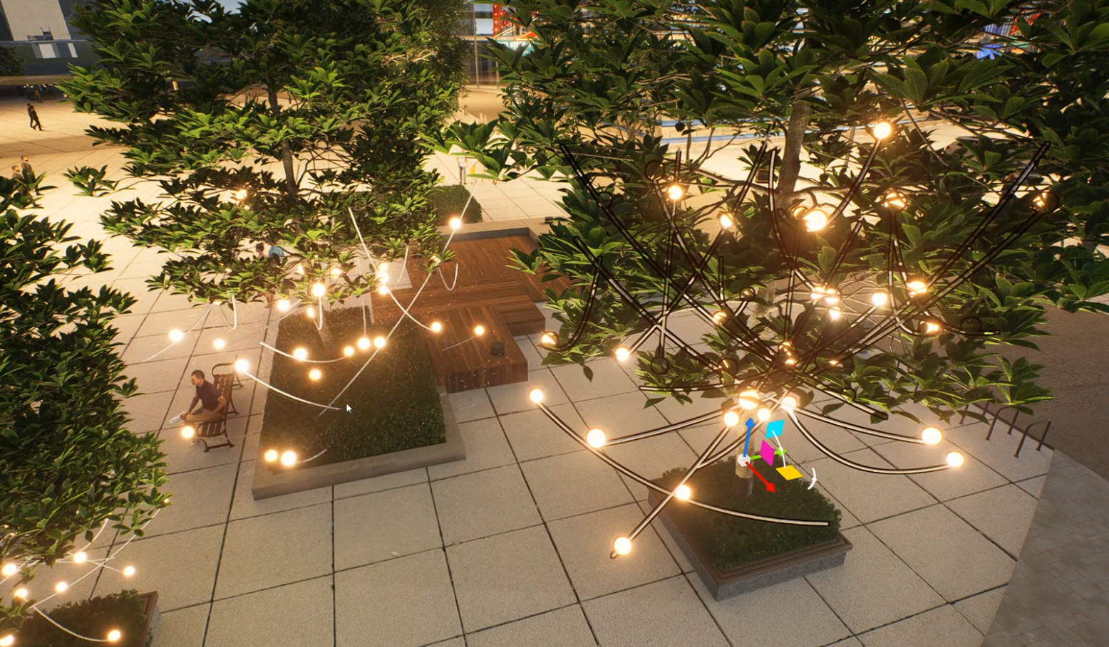

Here's a tip to quickly solve the problem of trees looking dull as we mentioned before: put a rectangular light near the tree's bottom. You can further put more landscape lights under the tree. In this way, they will be full of life.
Now you can see that the scene becomes gorgeous.

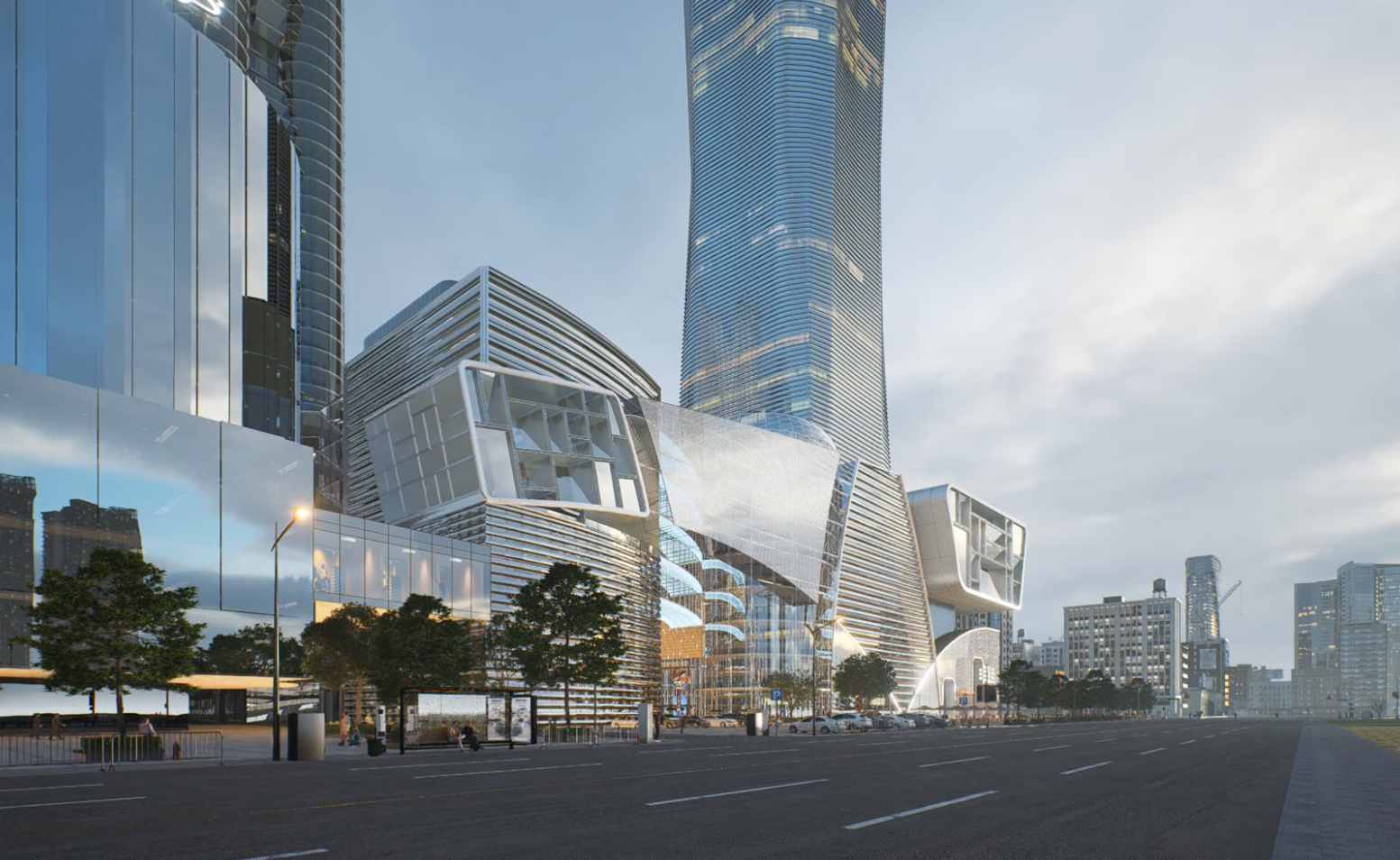

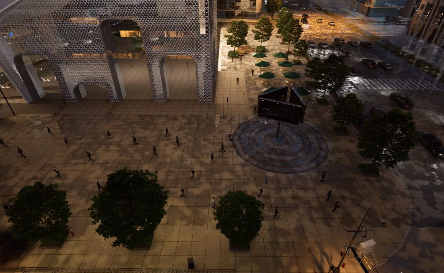

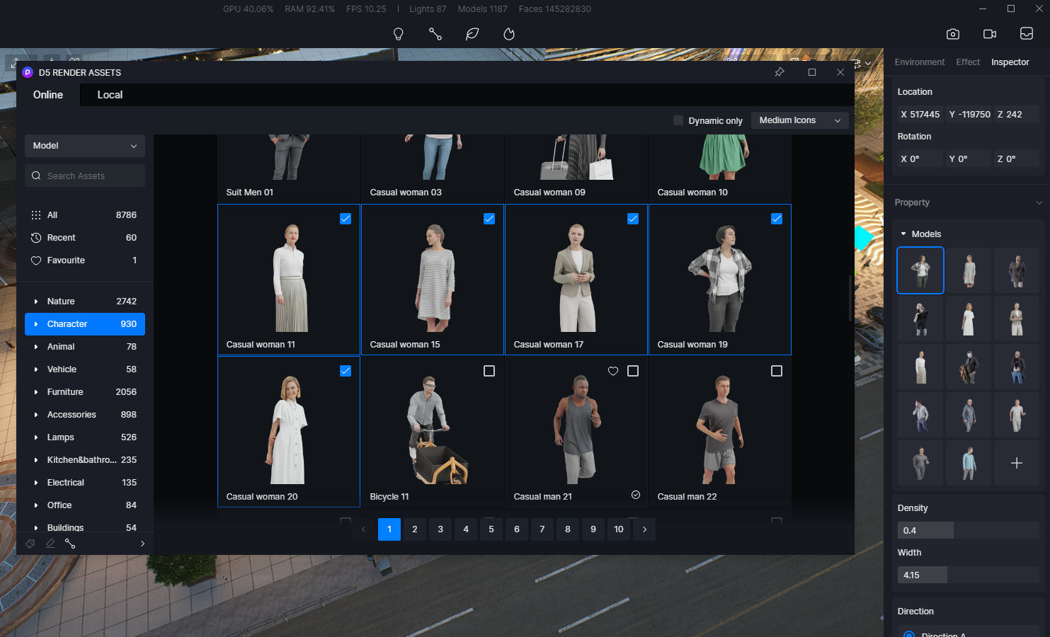

Then use the Path tool to quickly place character models on the plaza. You can choose dozens of still/animated characters from D5 Asset Library as a combo.

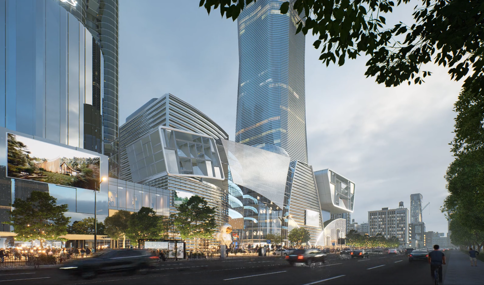

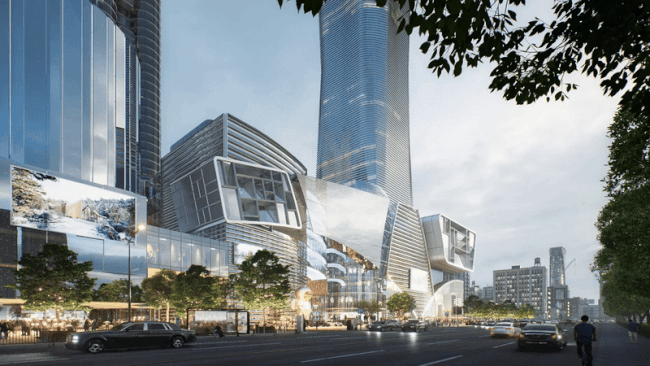

Finally, don't forget to put some trees near the camera, which will form a foreground, thus helping you better compose the picture.
