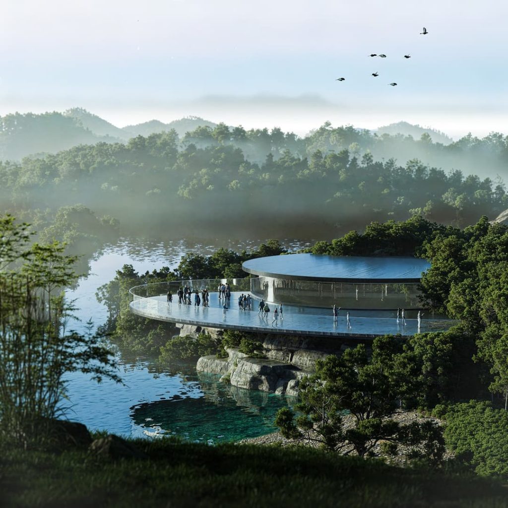

大気遠近法でレンダリングに自然な奥行きを出す方法
Artist: WALL STUDIO
When you gaze at distant skylines or mountains, you’ll notice they look paler, blurrier, and less defined. This phenomenon, known as atmospheric perspective, occurs as air particles scatter light, reducing detail and contrast with distance.
In large-scale renderings, this effect is critical to crafting depth and realism. Without it, even a beautifully modeled scene can feel unnaturally flat. D5 Render equips designers with intuitive features that replicate these natural depth cues—turning lifeless scenes into immersive visual experiences.
Artist: johncreation38
With D5’s height-based fog, you can mimic how air density changes with elevation. These tools let you add subtle veils that lighten distant areas and add ethereal softness.

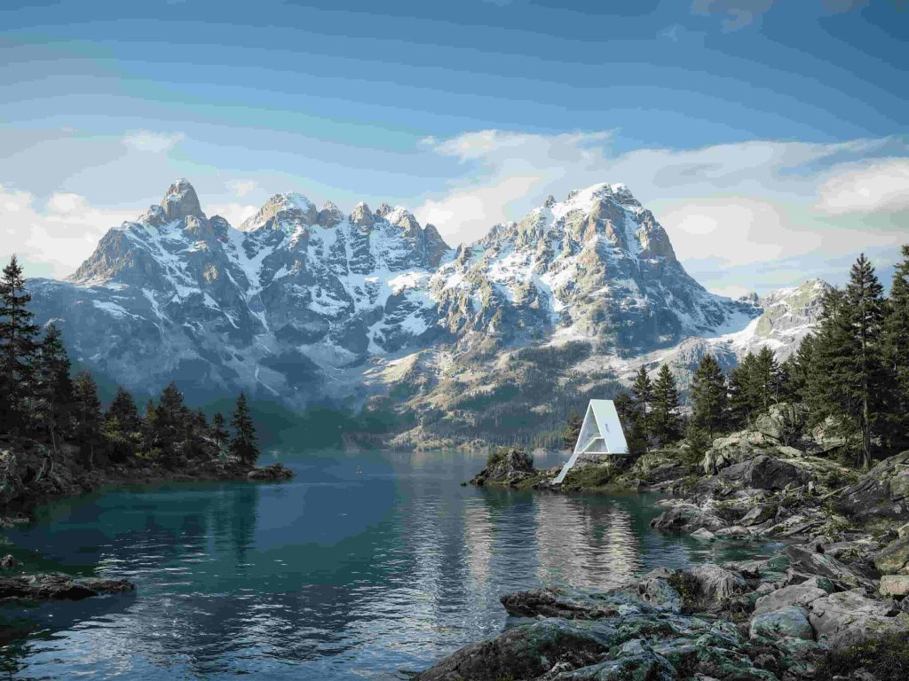

2.4 Depth of Field and Real-time Path Tracing
D5’s Depth of Field tool lets you mimic how cameras perceive distance. Used sparingly, it can help guide viewer focus without sacrificing realism.
For photoreal precision, real-time path tracing calculates how light behaves over distance, factoring in scatter and fade. Enable “Accumulate” for crisper, noise-free results in hazy or backlit environments.
Artist: Will Pickering
Realistic structure underpins good atmosphere. D5’s terrain tools help build undulating landscapes, while scatter tools populate them with natural variation whether it’s dense forests, rolling hills, or rocky expanses.
✅Pro Move: Use soft fog behind sloped terrain filled with scattered vegetation and set the sun low. This combination adds cinematic depth and richness.

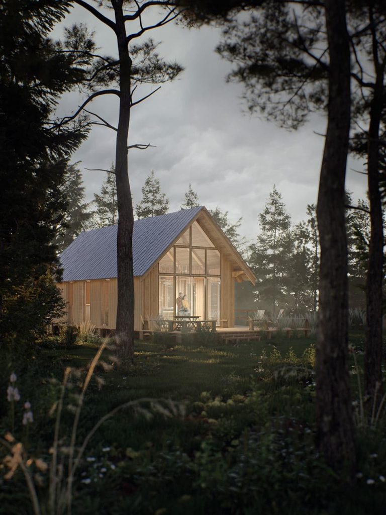

2.6 Post-Processing: Mood and Polish
Once the structural and lighting layers are in place, use D5’s AI-driven post tools to unify the feel of your scene:
  • AI Atmosphere Match adapts sky, lighting, weather, and tone based on the reference image to replicate the desired mood, whether it’s a serene sunset or a dramatic stormy night.
  • AI Enhancer analyzes your render and automatically improves contrast, lighting, and depth, perfect for dialing in subtle atmospheric effects.
  • AI Inpainting helps clean up render artifacts or fill missing details, especially useful for refining skies/waters or softening transitions in distant objects.

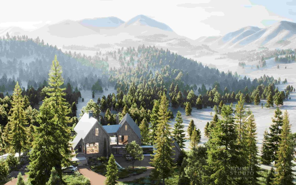

3.1 Kimmel Studio: Harmonizing Architecture and Landscape
©Kimmel Studio
キンメル・スタジオ, known for integrating classical architecture with lush landscapes, used D5 Render to strike the perfect visual balance between built form and natural surroundings. They leveraged D5’s scatter, vegetation, and lighting tools to convey narrative depth and realism.
“It’s like a creative puzzle, and D5 makes that process enjoyable.”
D5 Render’s ability to handle extensive models without lag proved transformative. Kimmel Studio could design and render vast neighborhoods and intricate landscapes without disruption, enabling a smooth, efficient creative process.

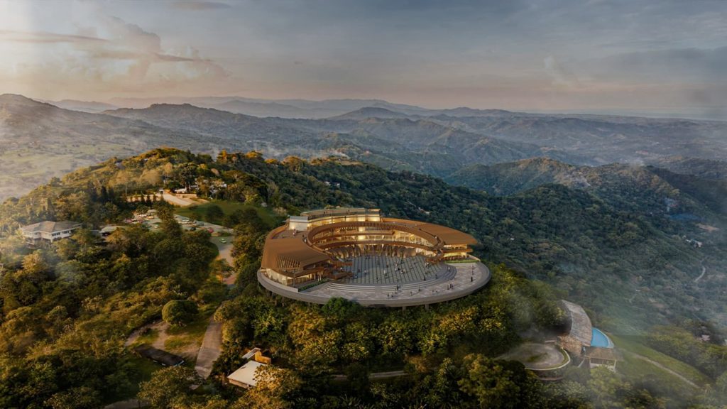

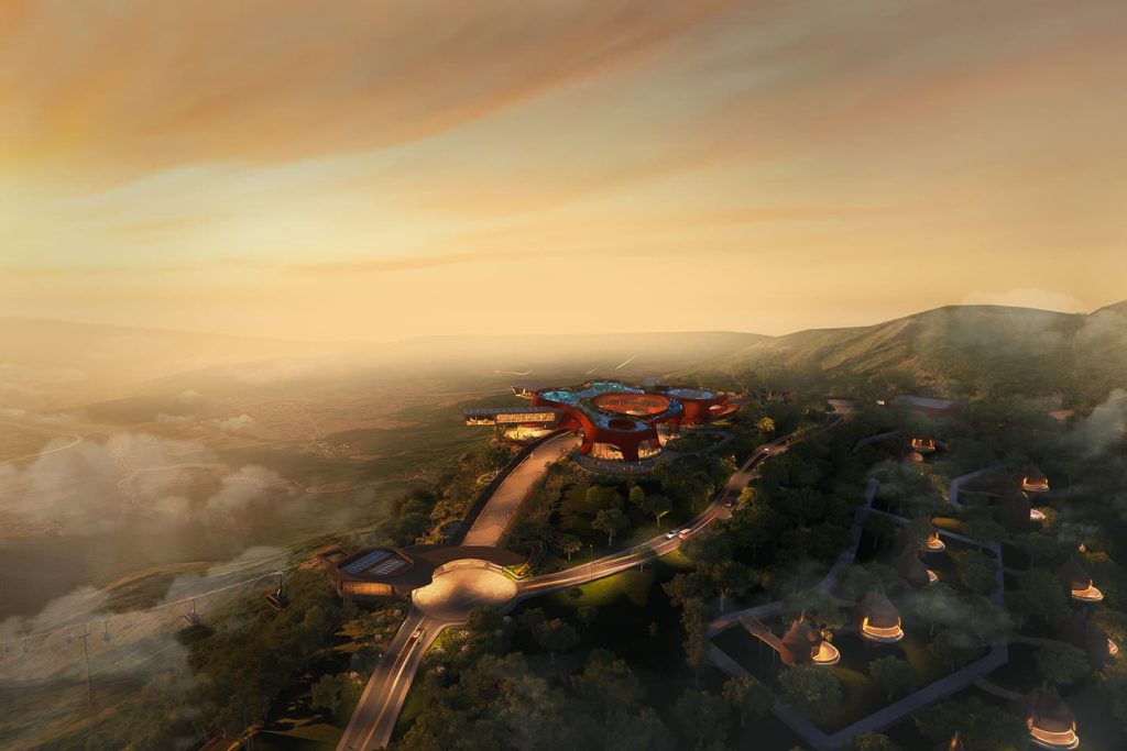

3.2 ArchiGlobal: Aerial Storytelling at Scale
Caniaw Crest | ©ArchiGlobal
Tops Redevelopment | ©ArchiGlobal
In projects like Caniaw Crest そして Tops Redevelopment, ArchiGlobal used D5 to emphasize the spatial relationship between built forms and their environments. Features like terrain sculpting, AI-enhanced atmospheres, and real-time lighting brought aerial scenes to life.
  • Storytelling through Layers: Use elevation, fog, and light to direct attention.
  • Effortless Realism: Create emotional impact with just a few key settings.
These studios show how atmospheric perspective isn’t just technical’s narrative. It helps your renders breathe, guide, and resonate.
