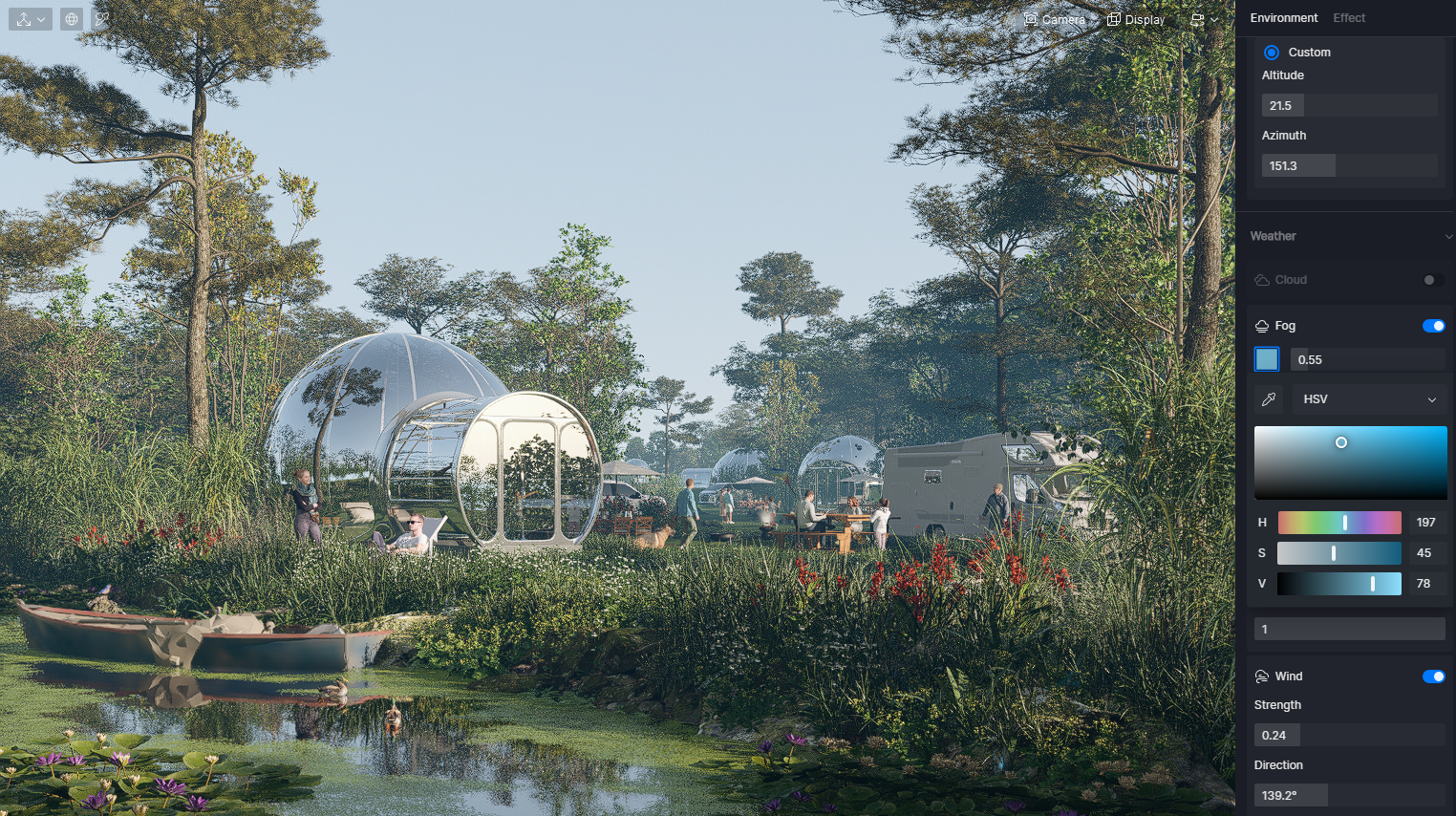

Adjust the color and intensity of fog

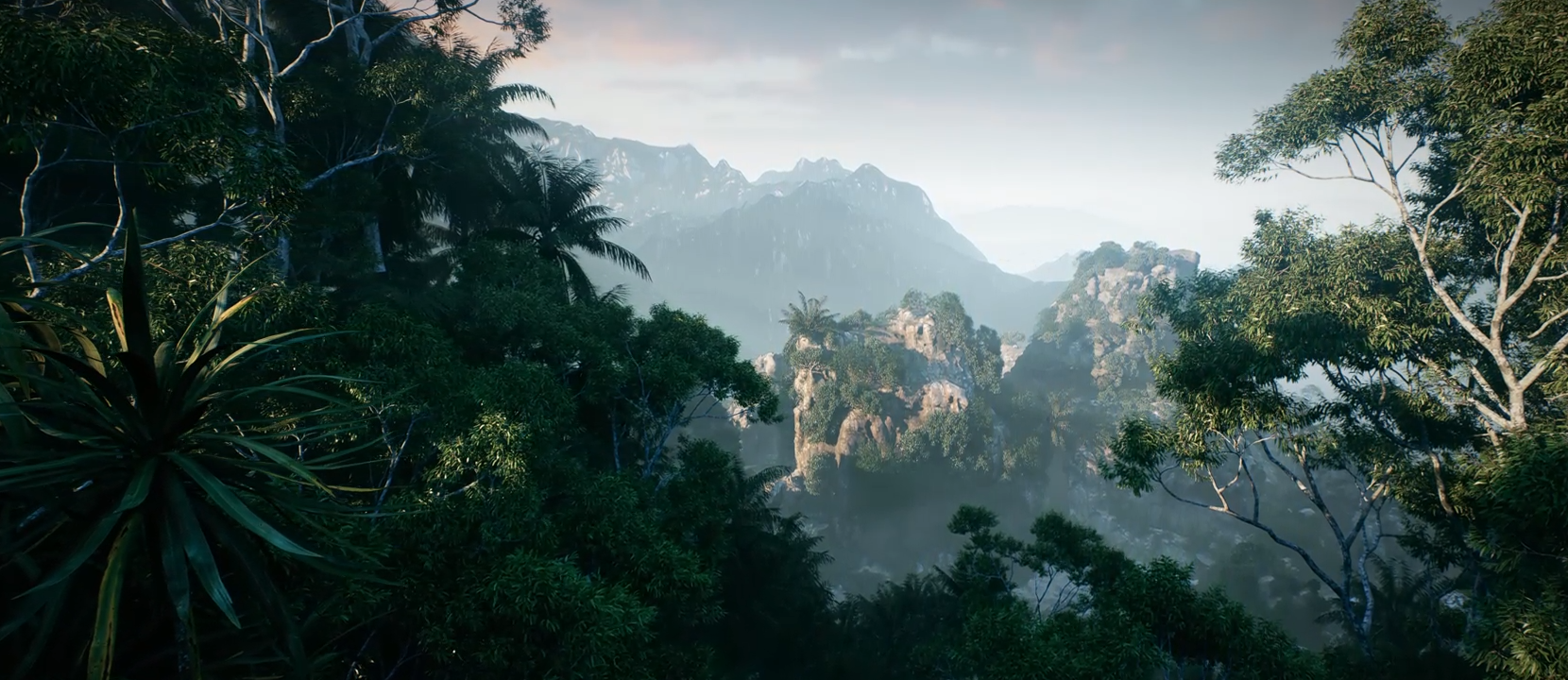

Bear in mind that fog is not purely white or gray. Its color is influenced by surrounding elements like sky and trees. So don't forget to set an appropriate color for the fog so that it fits into the environment.For example, in this scene, you can see that the fog has a tint of light blue. If white, the image would look a little pale and rigid. After setting the color, you can adjust its intensity. Normally 0.6 would be fine. If you want to simulate a noticeable foggy weather, you can pull the slider to the right

In this render, though the plants close by take up nearly half part of the image, you will still be attracted by the mountains far away at first. When it comes tocomposition, you can try adding something like plants close to the camera, and don't worry, the fog will still stand out and catch your attention when it blends into the background.

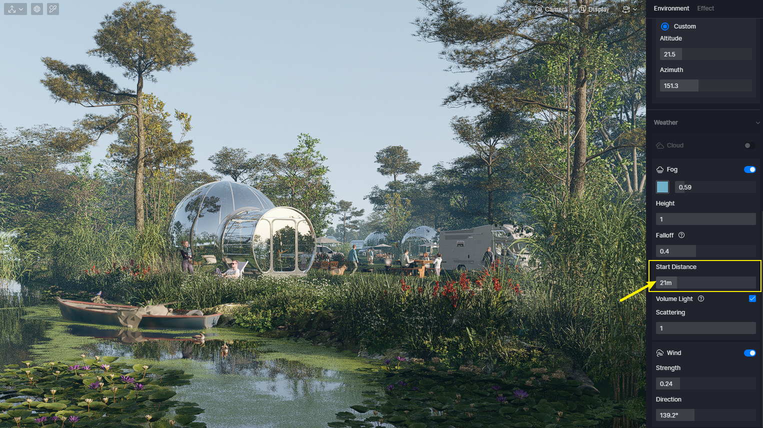

Adjust the start distance of fog
Think about the real world on a foggy day. The closer you are to the objects, the clearer the view will be. This situation is more obvious when the fog is very thin. In this case, it's better to make the fog start far away from the camera in render, especially when you just want to enhance the sense of depth.

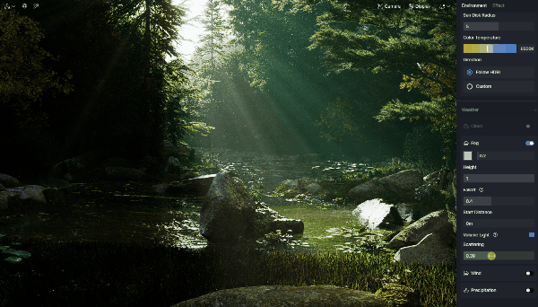

Use the combo of fog and Volume Light
What's Volume Light?
This effect is also known as "God Ray", which means the light path becomes visible when the light is scattered by particles in the air. It often happens when light passes through a crevice, such as a window or gaps between leaves. You must be familiar with the term "Tyndall effect" widely used in photography. Now you can easily make one yourself in D5 Render.
After turning on the "Volume Light" button, the fog will appear where the light is. You can increase the "Scatter" value to make it more visible.

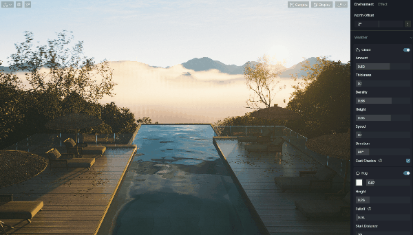

Add a finishing touch with clouds
Fog is a handy tool to create realisic and atmospheric visualization. So are clouds. Why not use them together to make the scene more vibrant?
Both clouds and fo effect are adjustable with several paramters, so you can make them as you like in different scenes and shots.
Fog: Color, Intensity, Height, Falloff, Start Distance, Volume Light optionCloud: Amount, Thickness, Density, Height, Speed, Direction, Cast shadow option
