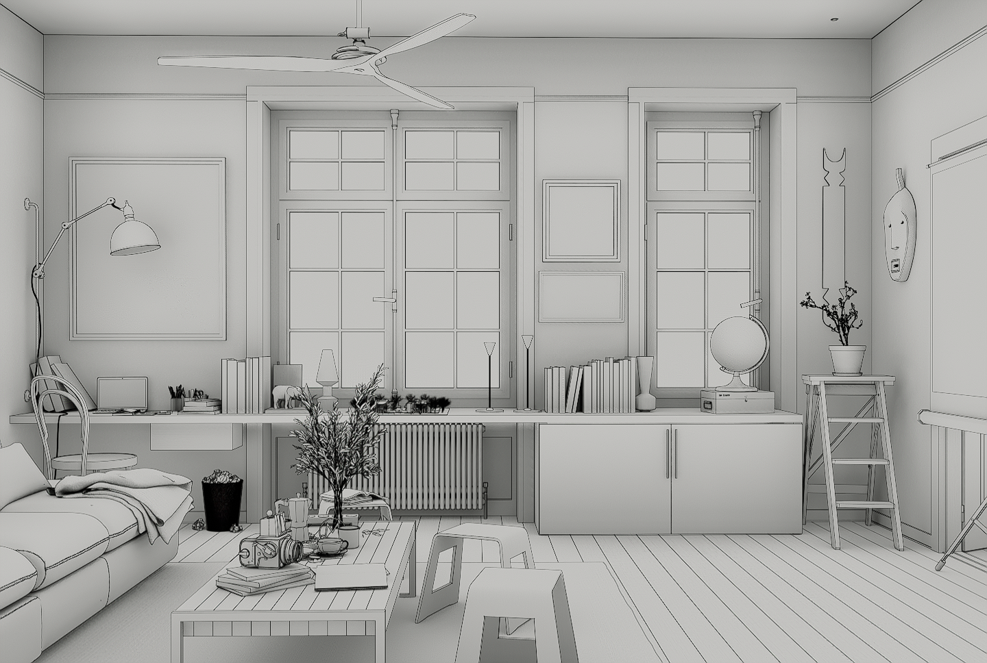

The AO-style rendering created with D5 Render

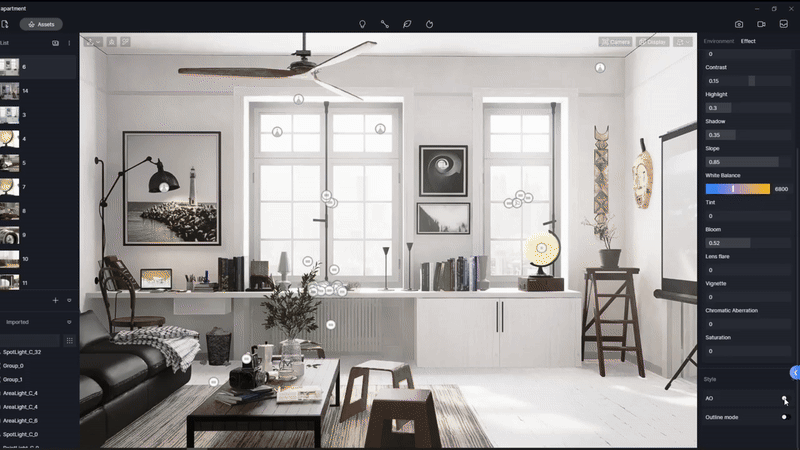

You can switch on “AO” in the effect panel and adjust its Radius to control the extent to which a location on the surface is obscured from surrounding light sources.

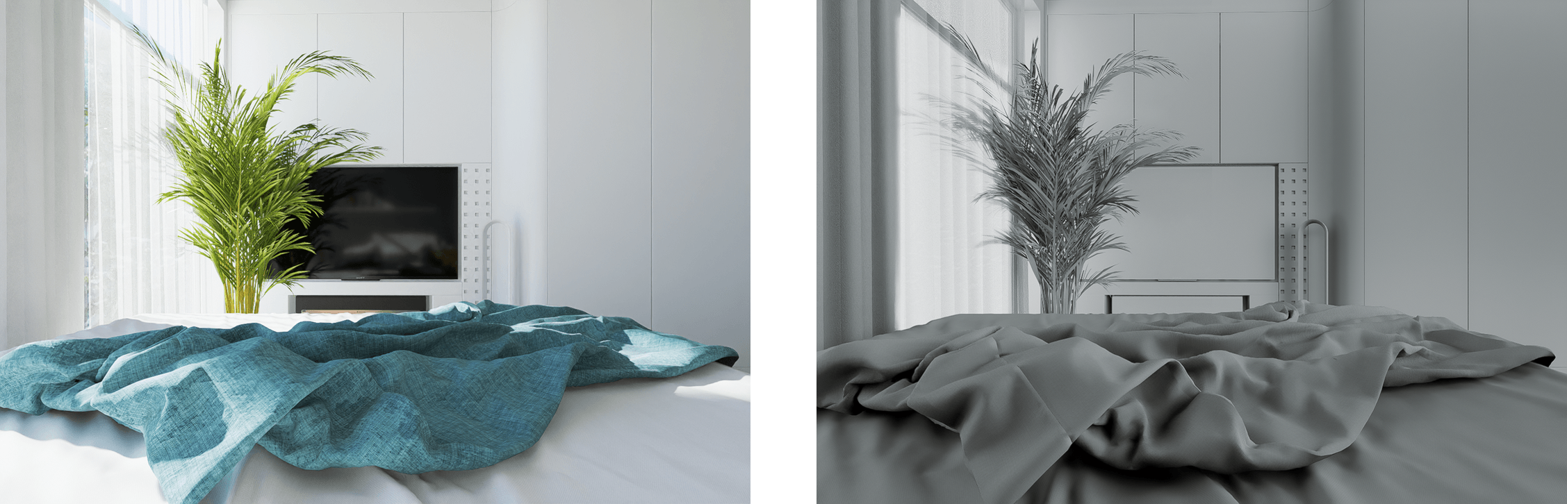

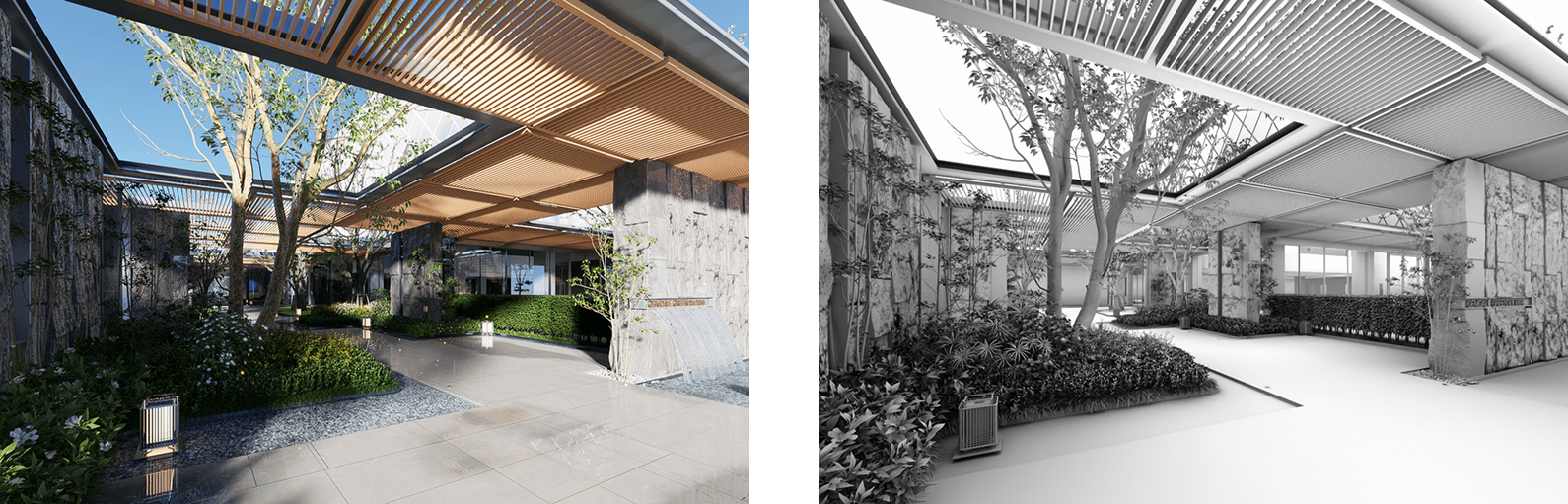

1. Use the AO map to enhance the details of light and shadow
AO maps help enhance the shadows in a scene. Visualizers usually use the AO map in Photoshop to produce a more realistic light-and-shadow contrast.
To output an AO map in D5 Render, go to Image Render > Channels and check “AO”.

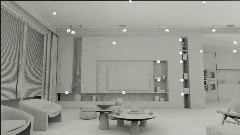

2. Use the AO rendering mode as a VFX
With D5 Render, AO can be a way of stylizing your work as well. You can achieve a special visual effect by turning on the “AO” mode. If combined with “Outline” mode, the rendering effect would be stunning and impressive.
Ambient Occlusion (AO) in D5: What It Is & How to Master It
Download the free scene file on D5 Forum
To create a rendering like this, you should go to the “Effect” panel, scroll down and find the “Style” section where the switches of AO and Outline modes are located.
The larger the Radius of AO, the wider the dark area will be.
