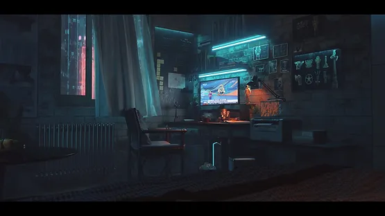

  • Emissive lighting also works like a charm when adding glow to surfaces like television screens or other electronic devices that are supposed to give off light.

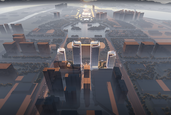

When Bloom effect is turned on, your’ll find a dazzling glow to the emissive materials in the scene, taking the rendering up a notch. For facade rendering in archviz, you can turn on Emissive with a little bit of intensity for the glasses or part of the structures of the architecture to glow beautifully in aerial view.

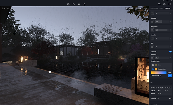

No custom maps. No material nodes. In D5 Render, emissive is a button in material editing tab. So you can just switch on “Emissive” for any material you picked to make it glow. Adjustable paramters include:
Intensity, controls the luminous intensity.Emissive color, controls the color of light emitted by the emissive material. (You can change its color by RGB, HSV, or HEX, or use the ‘Color Picker’ in the shape of a dropper in the ‘Color’ menu to get any color shown in the scene. Color temperature is available as well.)Cast Shadow, controls whether or not the emissive material participates in lighting (diffuse light) calculations. When this option is turned on, the material will be visible in camera and other material reflections, but it will no longer cast shadows and bounce light.

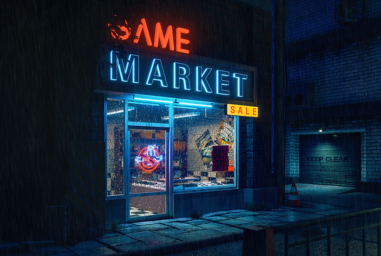

Decorate a night scene with emissive neon light signs
How to Use Emissive Material in D5 for Better Lighting?
Neon light signs are part of a prosperous urban night street, and to create a lively night city render, you can try emissive materials.

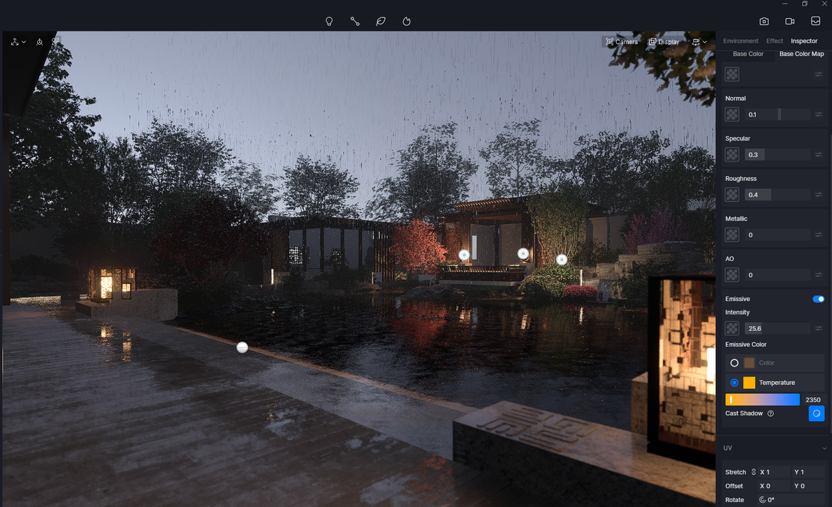

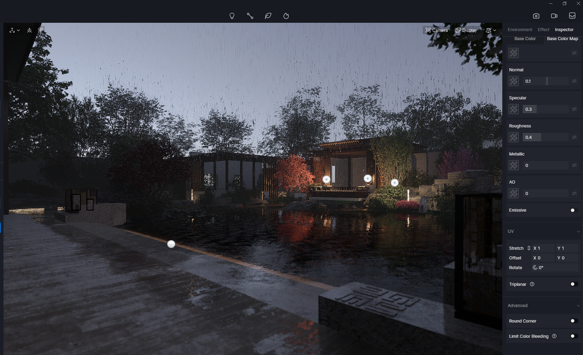

This is especially helpful when you want to create various kinds of lamps. In this rainy open courtyard, switch on Emissive for the lamps, and adjust the temperature to a warm yellow tone, so the scene does not look too cold.

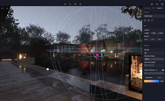

Then let’s add 3 point lights upon the emissive materials to illuminate the pavilion and surrounding plants, making them stand out from the dark background. Adjust parameters including intensity, attenuation radius and temperature properly to match the overall atmosphere. If you want a softer shadow cast on the wall, pull the Light Source Radius higher.

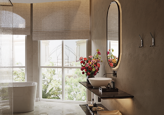

Lighting is an efficient method to enhance the sense of depth for a scene. While emssive materials alone can’t light up the main building far away from the camera, they are just right for lamps close by as supplementary lighting for the whole scene. Turning off emissive would make the scene look dark and dull, and if you use light sources instead, it might distract attention from the visual focus.
