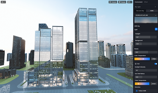

1. A nice overall atmosphere of the scene is a Must
Remember that a harmonious scene is the core of realistic rendering. How glass textures should look depends on what kind of atmosphere you want to deliver. Say we won't choose pilkington texture glass for the facade of a modern office building, so make sure to first adjust the general atmosphere of the scene.In D5, we can create a satisfactory global lighting effect with HDRI/Geo and Sky in the Environment system. With a few adjustments and preview, you'll get to the vibe you want.
To add your character to the visual, you can choose a suitable LUT from D5 or from your own collection. Exposure, Contrast, White Balance and more post-processing parameters are available right inside of this renderer, so you don't need to go to Photoshop or other photo-editing tools.
