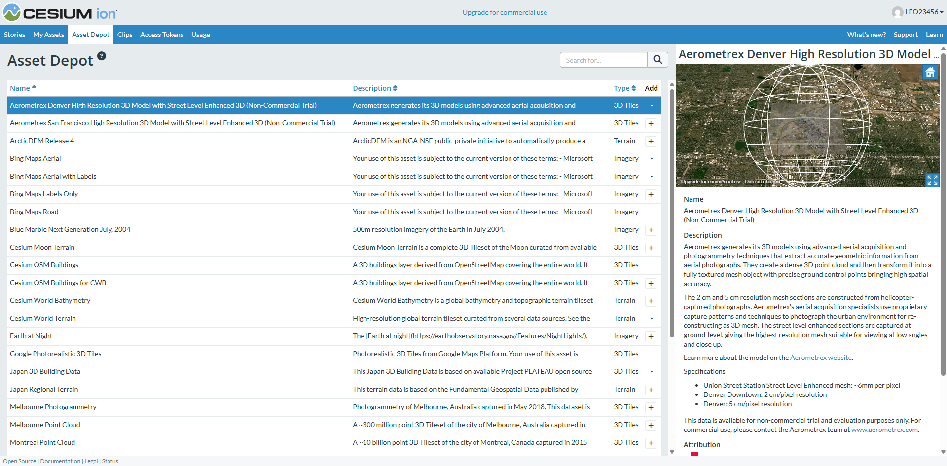

1️⃣ After logging in to Cesium, go to "My Assets" in the dashboard (as shown in the image below)—where you'll see all available [GIS data sources]. Along with default datasets, you can also upload custom models or survey data. A flexible platform for all your 3D mapping needs!
Want more data? Check out the Asset Depot to access additional official GIS resources (as shown in the image below), including 3D Tiles, terrain, imagery, and more—all ready to use in your Cesium 3D projects! Build richer maps with just a few clicks.
Important reminder: Commercial use of Cesium 3D mapping requires a paid subscription.

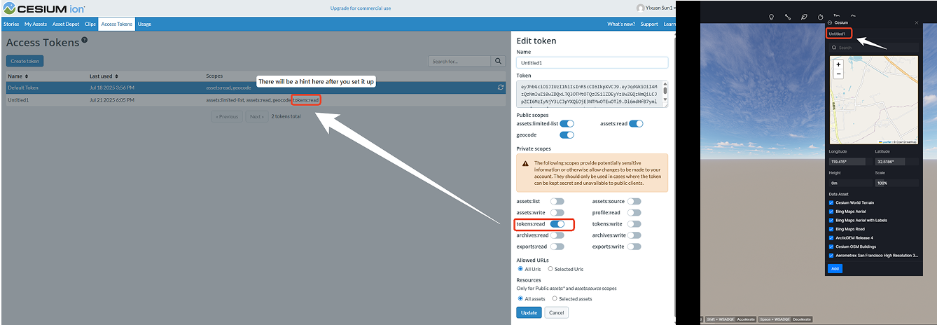

2️⃣ Then navigate to Access Tokens in your backend to create your API key. Note:
- Default Token: Automatically generated with full access to all your account data.
- Custom Tokens: Create restricted tokens that only access specific datasets - perfect for team members who don't need complete Cesium 3D access.
🔔 Cesium Token Setup Tip: When configuring tokens in Cesium as an admin, don't forget to enable the "tokens: read" permission (shown in the left panel below). This crucial step grants your team members' clients proper access rights. Otherwise, you'll find the token name field appearing blank in the Cesium interface (like in the right panel example)
3️⃣ To share a Cesium Access Token, log into the D5 Team Admin Panel and navigate to Assets/Resources → Cesium. Copy an existing Cesium token, then go to the top-right corner of the D5 Render Team Management panel and click 'Create' to paste it (as shown in the image below).

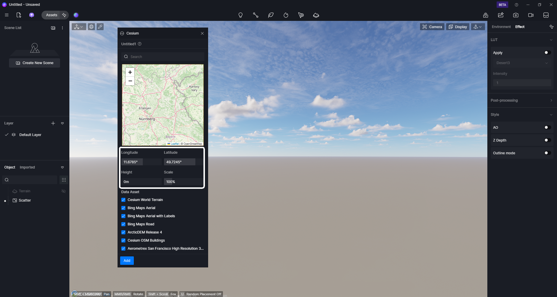

2️⃣ Getting started is easy: Enable Cesium, then either use the map widget or manually enter your project's latitude/longitude (as shown in the image below). The plugin will automatically create a geo-anchor at these coordinates (available data sources depend on what your admin enabled in Cesium's backend).
Now simply check which data layers you want to load - 3D terrain, satellite imagery, or 3D tiles - and they'll appear perfectly aligned in your D5 scene.
Quick Tip: Think of a Geo-Anchor as your project's GPS pin—it locks a specific latitude/longitude as the center point, with surroundings rendered only within a set radius. Once the 3D terrain, roads, or context loads correctly around your building, you're all set to focus on design!

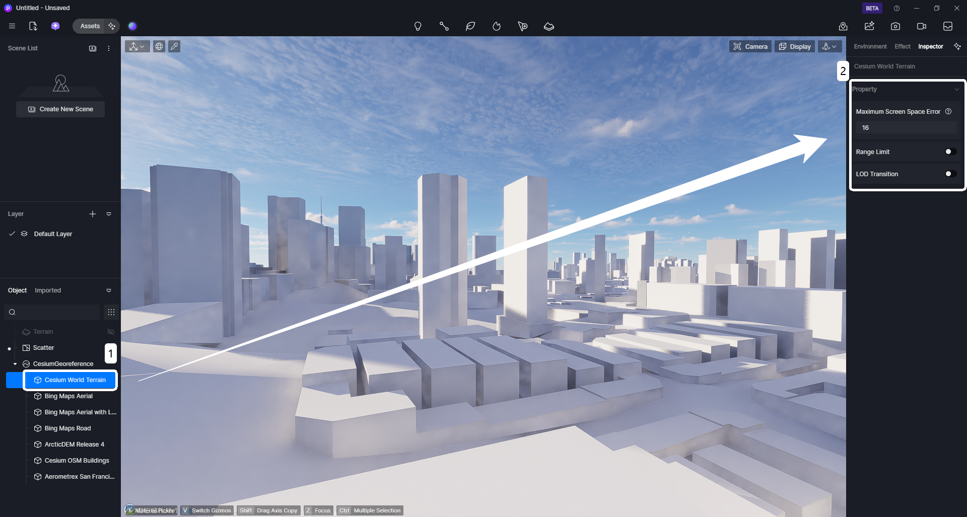

5️⃣ Adjusting Data Source Parameters. Simply click any data source in the tree structure, then fine-tune settings in the right-hand panel:
① Maximum Screen Space Error (0–100)
- 0= Highest precision (may impact performance)
- Higher values = Optimized rendering
② Range Limit (Toggle On/Off): Define a rectangular area with custom width/height.
③ LOD Transition: Smoothens level-of-detail changes for cleaner visual.
