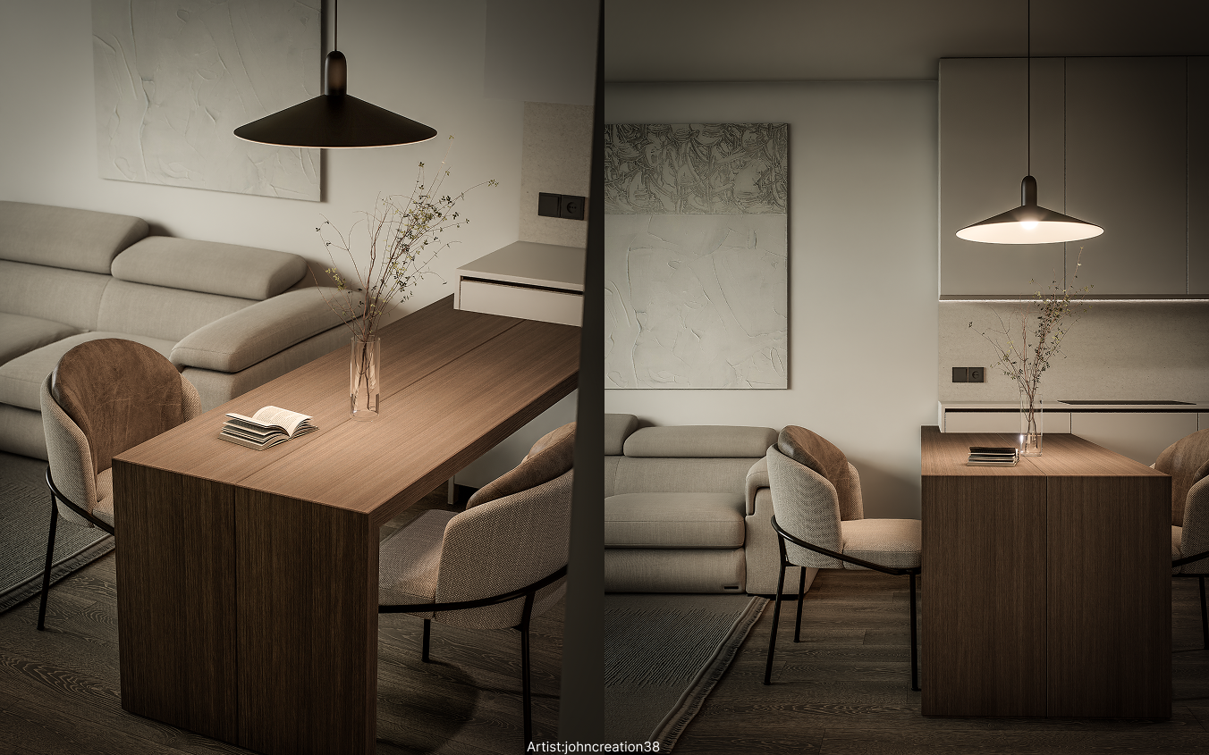

1. Point Light (Shortcut: 1)
Functioning as a digital bulb, the Point Light emits illumination uniformly in all directions. It is essential for fixtures like spherical pendants or table lamps requiring a soft, radial glow.
In D5 Render, control comes from the Attenuation Radius. When placing a Point Light inside a bedside lamp, a radius that is too large will wash out the room and flatten the image depth. By reducing the radius, you confine the illumination to the lampshade and the immediate nightstand. This creates a cozy, localized pocket of light that draws the eye without overpowering the global exposure.
8 D5 Render accent lights for cinematic real-time visualization
Creating a cozy atmosphere with Point Lights in D5 Render

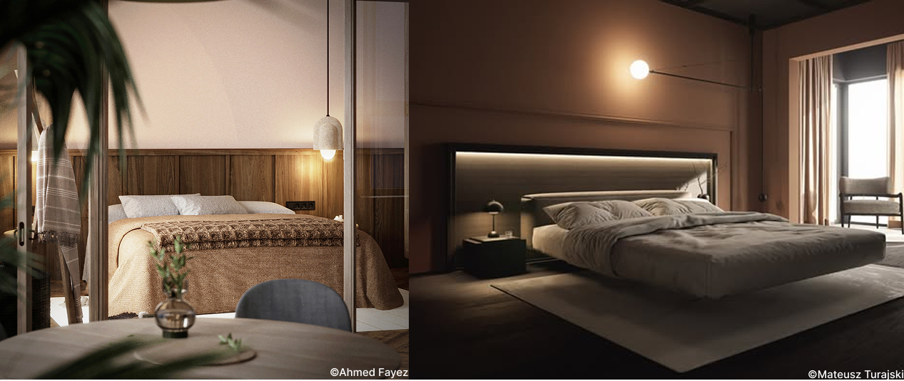

3. Strip Light (Shortcut: 3)
Technically, the Strip Light is a variation of the rectangular light source, optimized for linear architectural details where directionality is key. It creates a modern aesthetic where illumination feels integral to the structure, rather than applied as an afterthought.
The “Floating Kitchen” Setup: Tuck a Strip Light under cabinetry to wash light across a textured backsplash. A key refinement for realism: If your tiles are glossy, toggle off “Visible in Reflection” in the inspector. This preserves the beautiful illumination while hiding the artificial white reflection of the light source itself.
Enhancing spatial details with D5 Render Strip Light
Cove Lighting Application: Alternatively, utilize this tool for ceiling coves. Aim the light upwards with a warm temperature ($2700\text{K}$), allowing D5’s real-time GI to bounce a soft, ambient glow throughout the room. To ensure precision, use the Barn Door parameters to act as physical blinders, focusing the beam strictly where needed and preventing unrealistic light leakage through thin joinery.

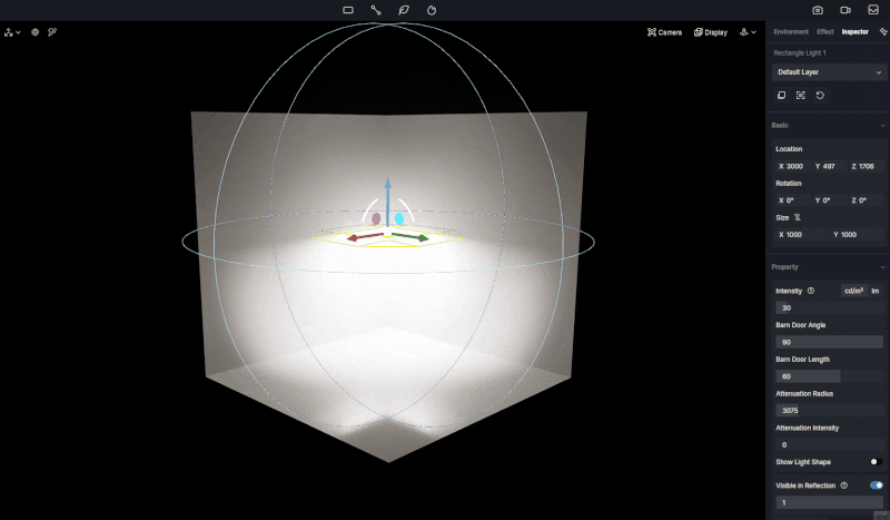

4. Rect Light (Shortcut: 4)
While the Strip Light handles linear accent lights, the Rect Light is your powerhouse for broad, diffused illumination. Essentially a planar source with a default Barn Door Length of 0, it functions like a photographer’s softbox, providing a consistent, even wash.
This tool is ideal for simulating overhead office panels or supplementing natural daylight entering a window without blowing out the exterior view.
Don’t overlook the “Barn Door” Angle. By default, this light floods the scene, but adjusting the angle allows you to constrain the beam. This transforms the softbox into a focused highlight—perfect for emphasizing specific furniture without spilling light onto unrelated areas, keeping your scene’s hierarchy purposeful.

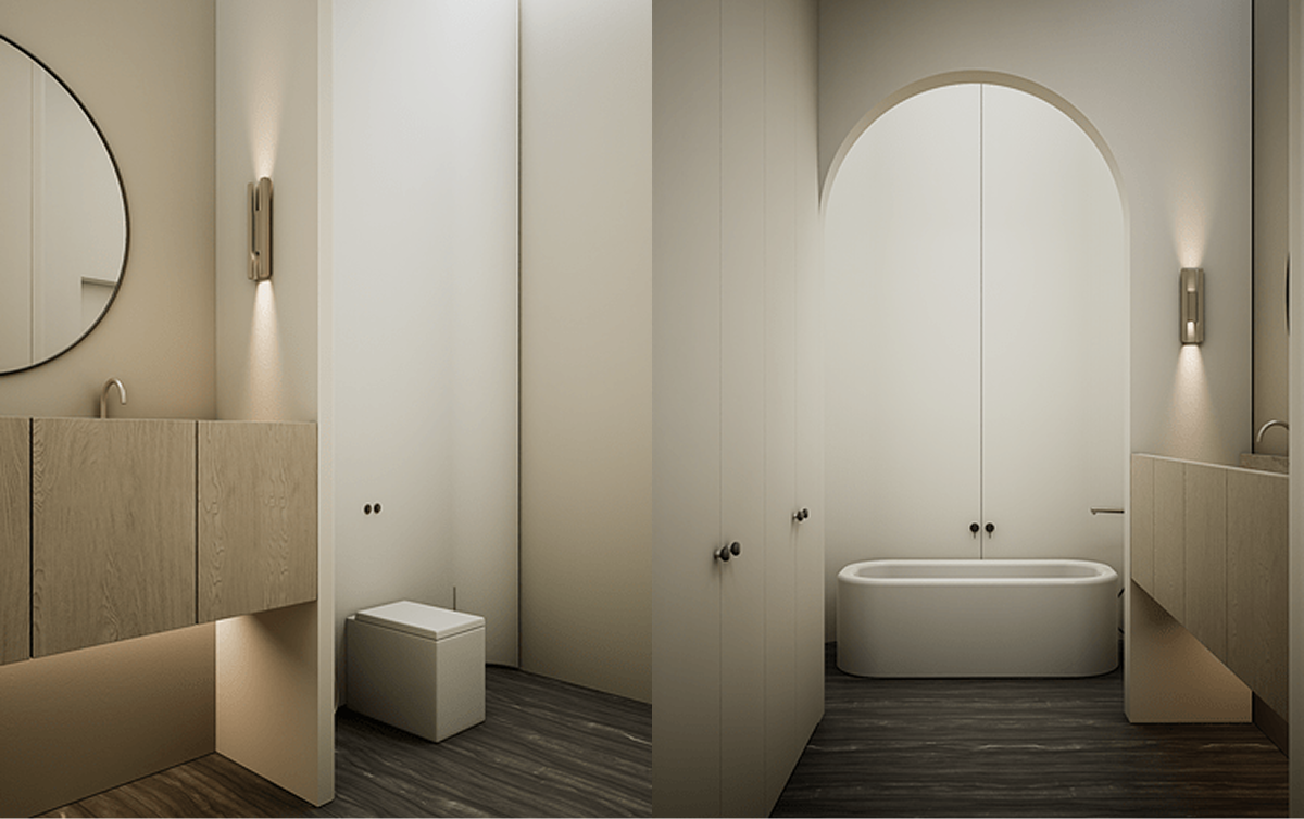

5. Disc Light (Shortcut: 5)
The distinction between a Disc Light and a Rect Light comes down to reflections. In scenes with glossy surfaces—like a marble coffee table or polished concrete—a square reflection from a round ceiling fixture breaks immersion instantly.
Opt for the Disc Light for circular ceiling spots or pendant fixtures to ensure specular highlights on your materials remain perfectly round. By adjusting the Light Source Radius, you can soften the shadow edges, mimicking the high-end, diffused look found in luxury hospitality design.
Crafting a soft, high-end atmosphere with D5 Render 디스크 라이트

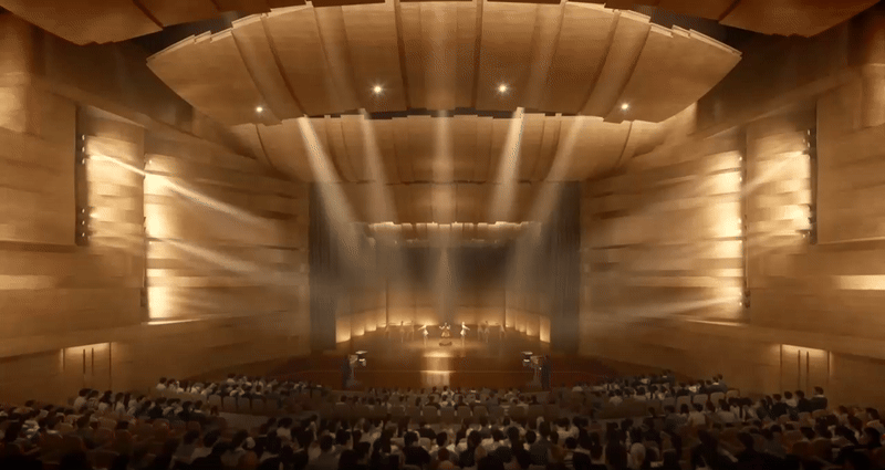

6. Stage Light
참고: Activate via Menu > Preference > Widget > Stage Light.
For moments requiring high-drama, the Stage Light is unique. Unlike other accent lights that focus on illuminating a surface, the Stage Light prioritizes the visibility of the beam itself.
This is perfect for automotive showrooms, concert stages, or creating a Tyndall effect (visible sunbeams) in atmospheric interiors. In D5 Render, this light cuts through the air with volumetric intensity. Use it to highlight a hero object, such as a sports car; the sharp, defined beam separates the subject from the background, creating an immediate visual hierarchy that standard spotlights cannot achieve.

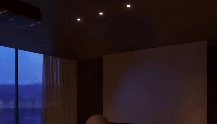

7. Projector
참고: Activate via Menu > Preference > Widget > Projector.
The Projector is a powerful asset for architectural storytelling, allowing you to cast an image or video file as light. It turns a simple wall into a dynamic canvas.
The Efficiency Hack——Simulating complex environmental shadows. Instead of placing a high-poly tree model outside a window (which increases scene heaviness), load a black-and-white image of tree branches into the Projector. Aim it through the window to cast complex, organic shadows onto the floor. This implies a rich exterior environment without the heavy computational cost, keeping your workflow fast and fluid.
Casting custom shadows with the D5 Render Projector

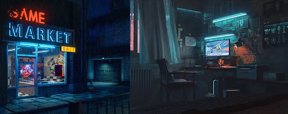

8. Bonus: Emissive Material
While technically a material parameter, Emissive settings are crucial for visible light sources like neon signs, LED strips, or screens.
However, relying solely on emissives to light a room often results in a lack of shadow definition. The Pro Workflow in D5 Render is a hybrid approach: Apply an Emissive material to your LED geometry so it appears to glow, then place a hidden Strip Light directly on top of it to cast the actual illumination. This ensures your accent lights look physically correct while maintaining the necessary lighting power.
Creating stunning glow effects with D5 Render Emissive Material
