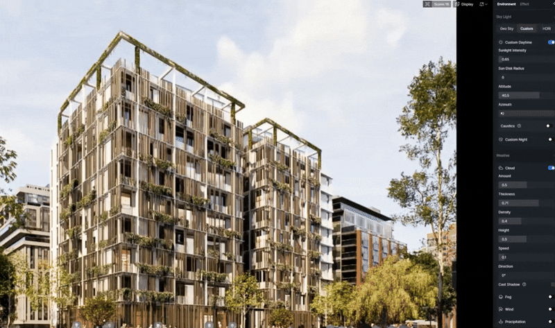

  • Take Full Control of Your Lighting Setup —The key to achieving realistic illumination in D5 Render lies in combining an HDRI sky with the Custom Sun tool. This powerful pairing allows you to fine-tune the sun’s intensity, size, and rotation, giving you precise control over shadow softness and highlight placement on your building’s façade, ultimately grounding your scene in a believable environment.
real-time exterior rendering in D5 Render with realistic materials, lighting, and layered depth
Adjusting the Custom Sun in D5 Render for Optimal Shadow Quality

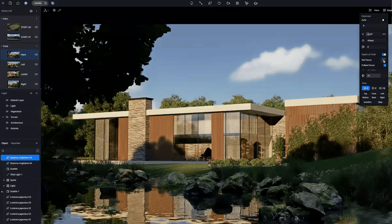

  • Build 깊이 Through Strategic Layering —Think of your scene in three distinct planes. Use a slightly darker, out-of-focus foreground (like foliage or a fence) to create a vignette effect. Position your building as the sharp, well-lit hero in the midground, and let the background—such as a soft sky or distant trees—recede to create a sense of immense depth and atmosphere.
What’s z-depth and how to use it
사용 심도 in D5 Render to create immense depth and spotlight the building as the hero
  • Frame Shots That Feel Natural and Intentional - 카메라 설정 significantly impact perception. Start with a focal length between 28-35mm for a natural perspective, or use a longer lens (50-65mm) to compress space for a dramatic, simplified composition. Don’t hesitate to experiment with aspect ratios; a 4:3 or vertical crop can often be more compelling than the standard 16:9.

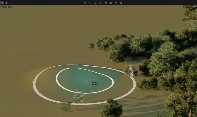

Once your lighting feels right, start layering details. This is where small, intentional touches turn “nice” into “believable.” Maybe you sculpt a simple pond using D5’s water material , then surround it with lilies, stones, and reeds. Connect the structure back to nature with ivy climbing the walls or a meandering stone path that grounds the building naturally.

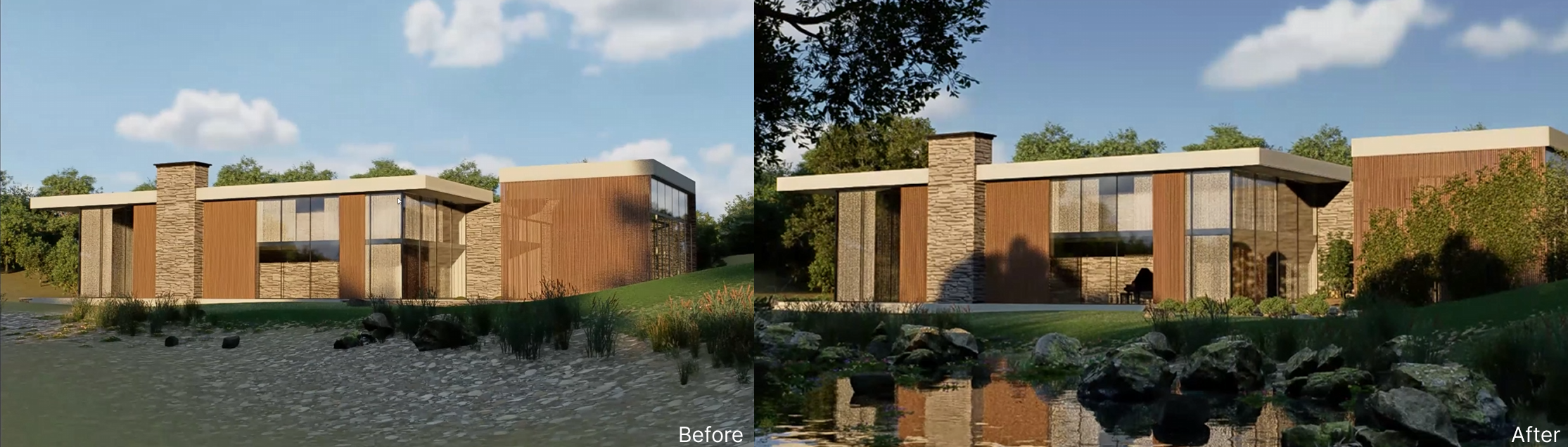

Before vs After: original scene versus a D5 Render output enhanced with refined details
Finally, add life—but sparingly. A tree casting soft shade in the foreground or a warm interior glow in the distance is often enough to hint at a story without clutter. Don’t chase perfection; aim for balance. When everything comes together effortlessly, your exterior rendering in D5 Render stops looking like a model—and starts feeling like a moment.
