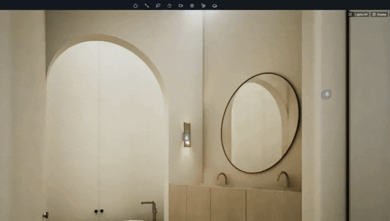

First, here’s a pro tip that might feel counterintuitive: the first step to crafting beautiful interior lighting isn’t about placing a single lamp. It’s about giving yourself the light to see what you’re doing.
Before you get lost in the dark, open up D5 Render and drop in a section plane . Make sure to check the “Affected by Light” box—this lets you borrow some temporary daylight from your Environment HDRI . Think of this as your “worklight” mode; it’s not the final look, but it lets you arrange your scene and evaluate materials clearly, without the guesswork.
Once your layout is set, simply disable the section plane. This initial setup is a game-changer—it prevents those frustrating exposure swings later and sets a solid foundation for the authentic artificial interior lighting you’re about to build.
Interior lighting with D5 Render: Achieve realistic, soft, and balanced lighting for dark rooms
Dropping a section plane in D5 Render

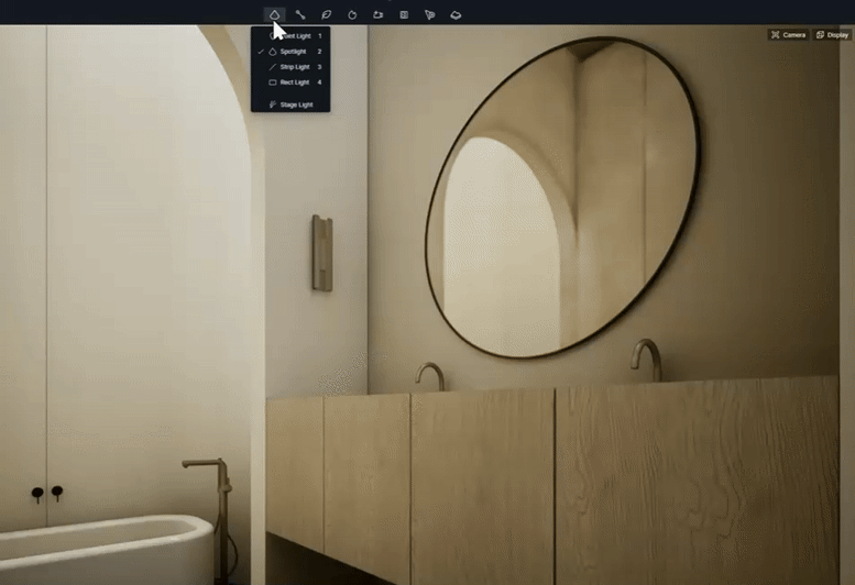

The most believable interior lighting always honors the architecture. In D5 Render , please always start by placing lights exactly where the real-world fixtures belong.
  • Anchor Your Scene with Realitys : Populate your scene with sconces, under-cabinet strips, and ceiling cans first. This foundational step ensures your interior lighting scheme is believable and architecturally grounded from the start.
Light a scene with wall sconces in D5 Render

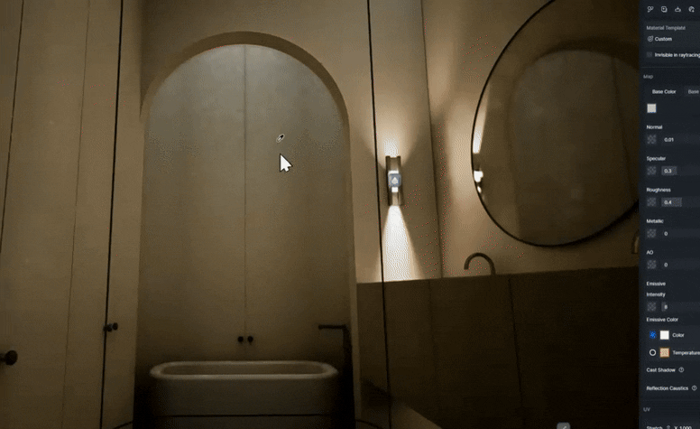

  • Use D5’s Built-in IES Profiles for Authentic Lighting Behavior : For fixtures like a sconce that casts light both up and down, leverage a bidirectional IES profile (like IES 05 ). This instantly replicates complex, real-world light distribution, making your scene look professional.
  • Dial in Warmth & Avoid Overload : Set the mood intentionally with color temperature. A warmer range (around 4000–4300K) often feels inviting in spaces like powder rooms. The key is to keep the intensity modest—you want warmth, not an overwhelming orange glow that flattens your materials.

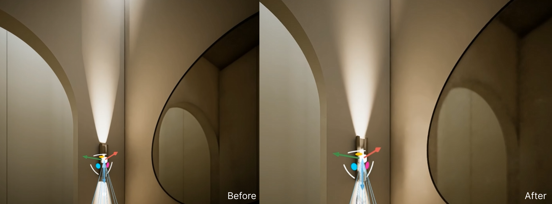

  • Soften Edges to Kill the “CGI” Look : This is a game-changer—increase the Light Source Radius. This simple tool in D5 Render softens harsh edges and eliminates those unnatural “scallops” on walls. A larger radius creates beautifully diffused, flattering gradients that scream high-quality interior lighting, not a basic render.
Soften shadows by increasing the Light Source Radius in D5 Render
Here’s a golden rule: perfect a single fixture first, then copy and paste. This ensures your lighting remains beautifully consistent from every angle.

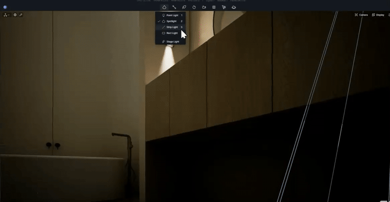

Use strip lights to create a soft under-cabinet glow. Keep the intensity low and pay attention to the Attenuation Radius—that handy cyan sphere in the viewport. It shows you exactly where the light’s influence falls off, helping y ou control spill and create a natural look, especially when using 실시간 경로 추적 .
D5 Render의 실시간 경로 추적이란 무엇이며 왜 중요한가?
Creating a soft under-cabinet glow with strip lights in D5 Render

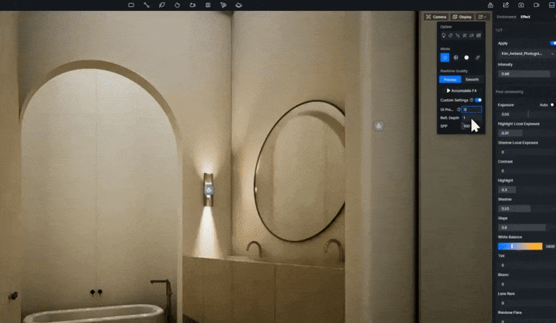

Now for the magic that brings your interior lighting together in D5 Render . Begin with a “temperature check,” balancing warm sconces with cooler (~6000K) overhead lights to keep material colors accurate—and remember to fix issues at the source, not in post. Once your color balance is set, ensure all light intensities are within a similar range so that no single fixture dominates, allowing the entire scene to emit a cohesive glow.
Then, switch to 실시간 경로 추적 with Accumulation, set the SPP value to 100, and increase Max Bounces—increase GI Precision and Reflection Depth as needed. This is where the magic happens: light bounces softly into corners, edges glow naturally, and your materials gain beautiful depth.
D5 GI | 글로벌 일루미네이션이란 무엇이며 왜 필요한가요?
Switch to 실시간 경로 추적 with Accumulation in D5 Render for photorealistic light rendering
A quick tip: if your scene looks too bright, lower the camera exposure first before adjusting individual lights. This preserves the perfect balance you’ve worked so hard to create, giving you that photorealistic finish we’re all after.
