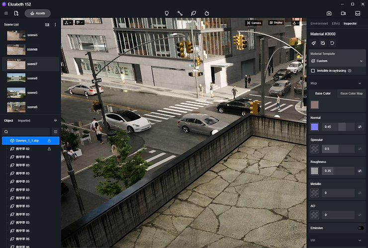

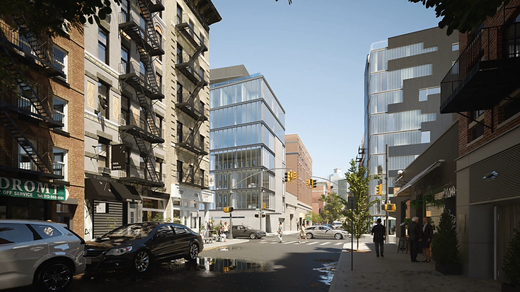

“We used Sketchup, 3ds Max, Quixel, D5, Photoshop and Premiere for making the scene.”As for modeling, we restored the main building based on the floor plan and photos collected online. Side buildings and streets were modeled with the help of satellite images and streetscape to bring back the real surroundings as much as possible. During the process, we applied PBR for all maps. We tried to live up to the real thing for even details like the patches on asphalt streets and where to place manhole covers. When all the modeling is done, we imported .skp files directly into D5 and .max files through D5 Converter – 3Ds Max, and then put everything in place. Next, we adjusted the scenes and arranged the animation clips. Last step, some editing, toning and background music are fixed in Premiere.

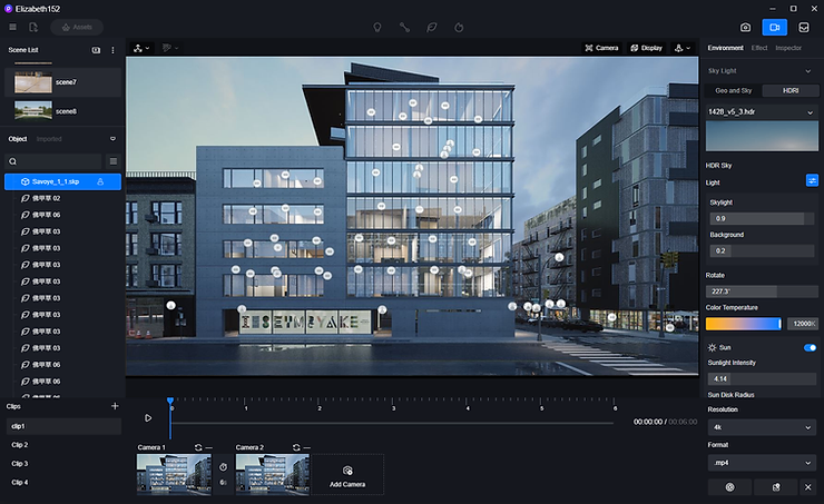

Q: How did you match the colors and set lighting for the whole scene?
For example, in the night scene, we used photographers’ favorite Blue Moment to set the tone for the picture. An HDR at sunset was used for a blue skylight. Then we placed some warm lights inside the buildings to light up the interior space, so as to create a contrast of cold and warm.
*Note: Blue Moment refers to the short period of time before sunrise and after sunset, when the sun is just below the horizon and sky gives off a soothing blue. Pictures taken at this moment has a high saturation in blue, making this time of the day a great timing for photography.
Can D5 Render Perfectly Capture Tadao Ando’s NYC Masterpiece?
ヒント Colors visually give people different sense of distance. Cold colors makes us feel distant, while warm colors pull us close. Such lighting contrast gets to highlight the building that we want to stand out.
We didn’t add a lot of light sources outside the main building. Considering too many light sources or poorly-organized lighting only make the scene lose its focus and weaken the expression of the main building, just a few mild light sources were placed to add to the overall atmosphere.  The last step, we fine-tuned the scenes in D5 and applied LUT to make the scene and colors in harmony.

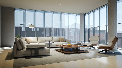

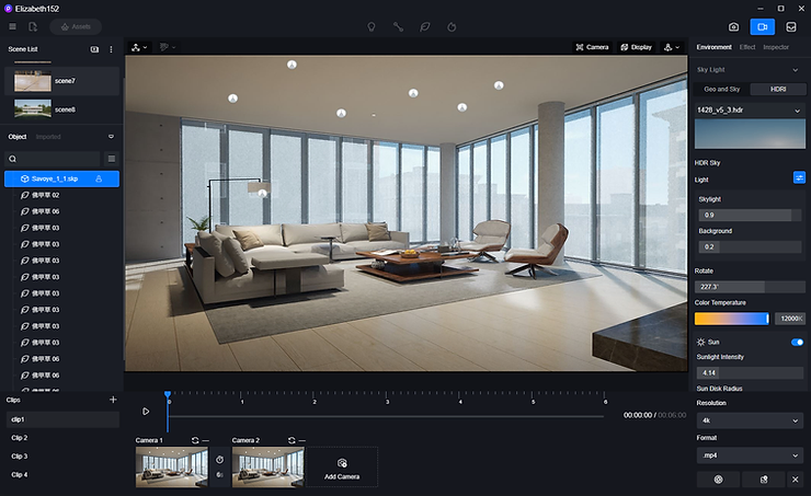

Considering the features of urban luxury condo, interior lighting is aimed at creating a soft and warm family atmosphere. That set the tone for our lighting: create the atmosphere using warm lights in warm scenes.
When it comes to lighting, I would set the spotlight according to the light layout in real life, and add skylight for moderate compensation.Real-life photography technique for lighting can be seen in some scenes where rectangular light is used to simulate softbox for the light to go indoors in a softer way.Where there is light, there is shadow. Shadow is what gives objects all kinds of layers in between. So we added some spotlights to shine on furniture, building up the layering of space.
Output | Created with D5 Render
Tips:Photography of interior projects is worth a view. Try to analyze the lighting tricks of photographers, and use light sources to stimulate supplemental lighting in real life.

“Maps are mostly made with PBR textures”For buildings, we selected corresponding maps according to the images, or we would browse through D5 assets library for suitable materials to perfect the details.We cropped out parts of the street image and processed them in Photoshop to produce materials in consistency with actual ones, which can be used after UV is adjusted in modeling software.Based on real-life streetscapes, streets were divided into parts for details. Grayscales were taken into consideration to determine how the streets look when flooded.
