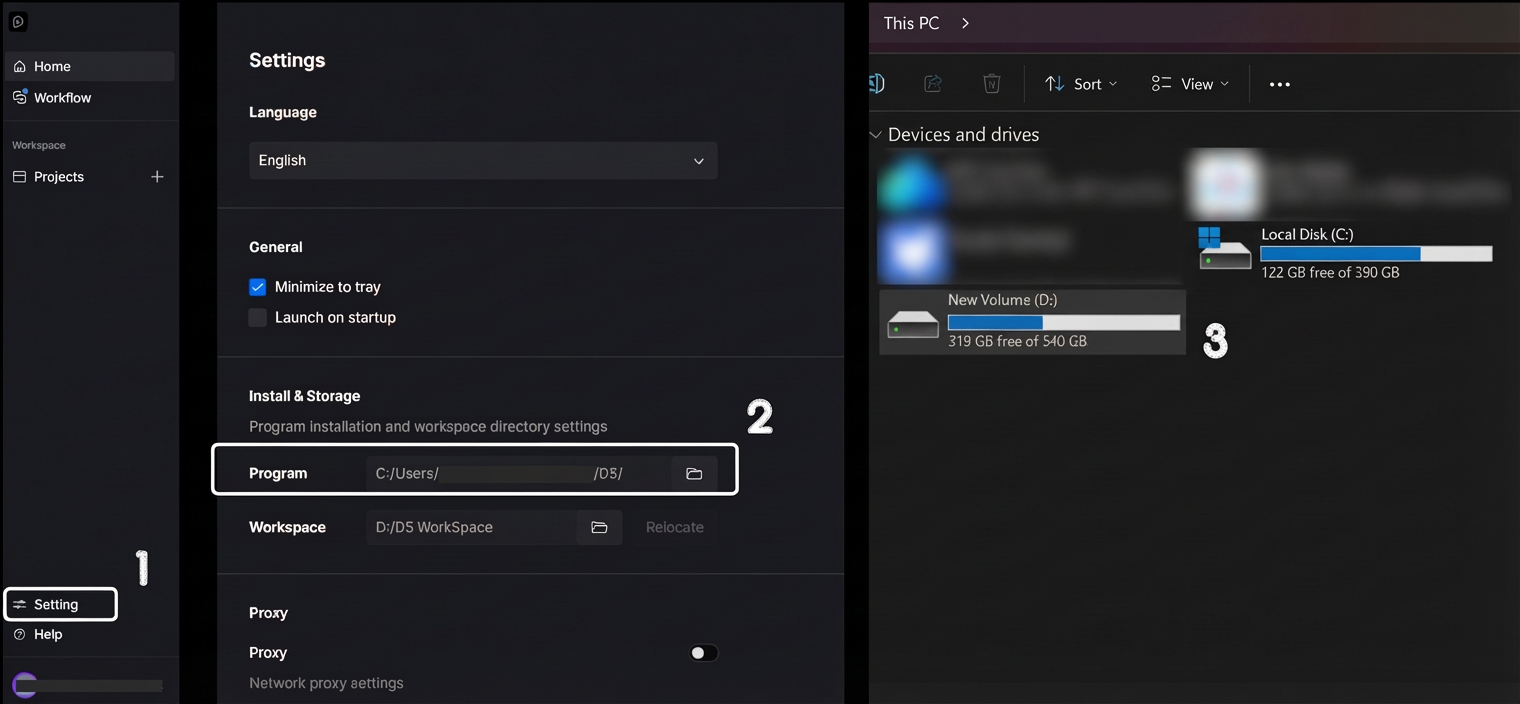

1. Optimize Your Workspace Location
Before fully immersing yourself in a creative workflow with D5 Render, it is essential to establish a solid technical foundation. Think of this as giving your software the “room to breathe” it needs to perform its best.
We highly recommend configuring your D5 Render workspace on a drive  with ample capacity—specifically, allocating at least 40 GB from the start. Why is this buffer necessary? As you pull high-fidelity models and materials from the asset library, your local cache will naturally expand. Ensuring you have this dedicated space guarantees that you can design freely, without the frustration of storage bottlenecks disrupting your momentum mid-project.
D5 Render UI guide: 7 settings on how to render efficient architectural scenes
Locate your D5 workspace on a high-capacity drive

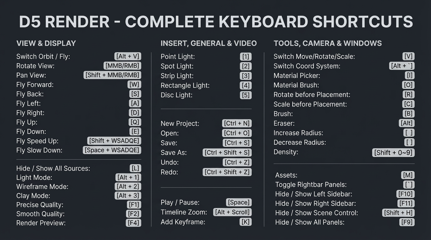

2. Master the Shortcuts (and Make Them Your Own)
Efficiency is everything in real-time rendering. We know that navigating a 3D environment fluently relies heavily on muscle memory. That is why D5 Render is designed with total flexibility: not only does it provide a set of intuitive default shortcuts to get you started, but it also fully supports customization to match your personal habits.
You can easily view and customize your key bindings via “メニュー” > “Preference” > “Shortcuts“.
For instance, swapping the default vertical camera controls (“Q” for up, “E” for down) is a common adjustment for users migrating from other tools. This flexibility ensures that your navigation feels natural from day one. We recommend keeping the shortcut panel open initially; customizing these inputs allows you to navigate 3D space subconsciously, letting you focus on how to render the perfect composition rather than thinking about which key to press.

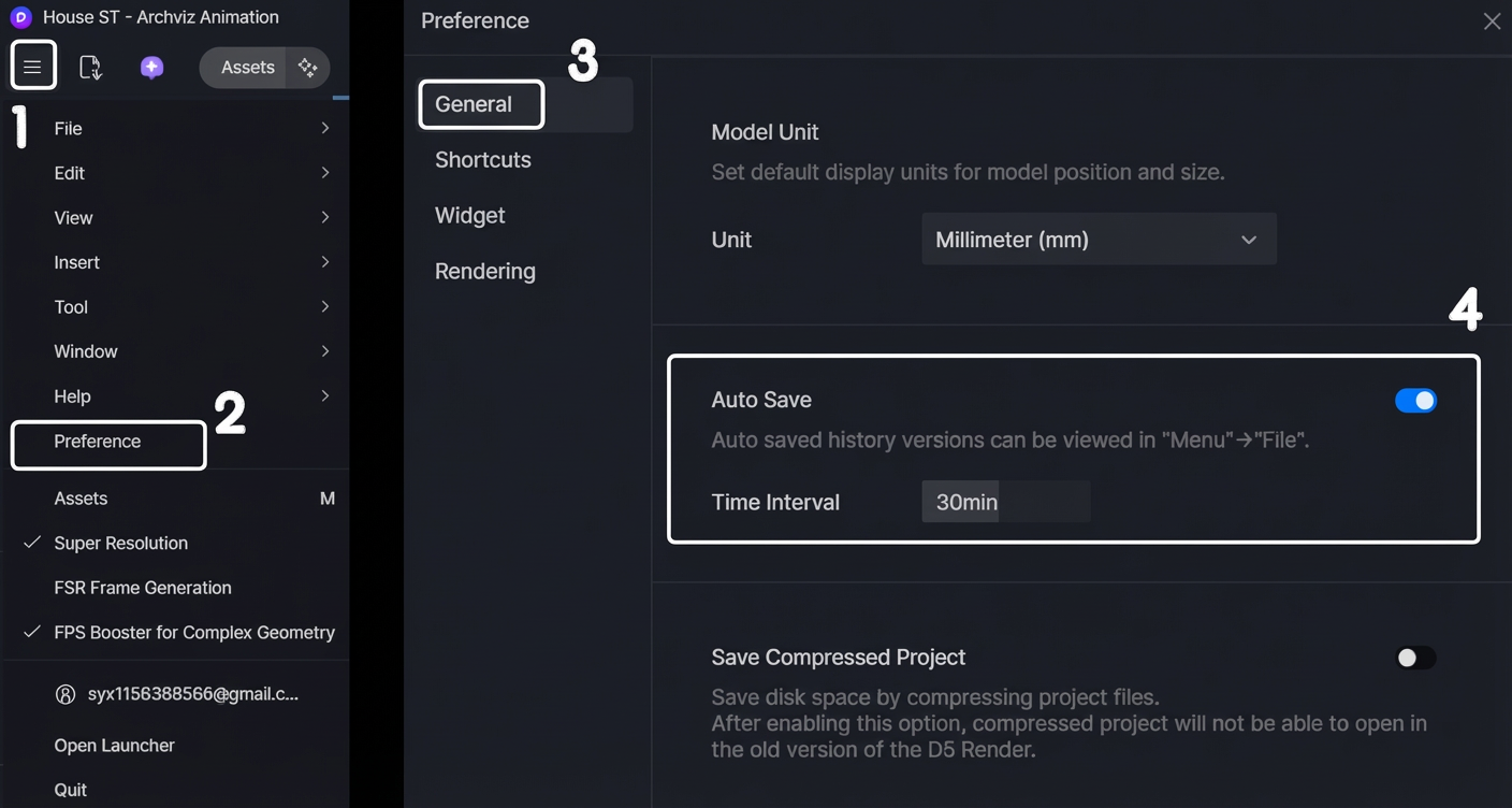

4. Smart Auto-Save Configuration
There is nothing more frustrating than losing progress to an unexpected interruption. However, setting your backup frequency too high comes with a trade-off: it can rapidly consume your available disk space.
To strike the ideal balance, navigate to “メニュー” > “Preference” > “一般” > “Auto Save” and set the interval to 30 minutes. Why this specific timeframe? It provides a secure safety net without generating an excessive number of backup files that clutter your project folder.
Configuring the auto-save interval in D5 Render
For added peace of mind, D5 Render includes a built-in recovery feature. Should the unexpected occur, you can restore your progress via “メニュー” > “File” > View Historical Versions.

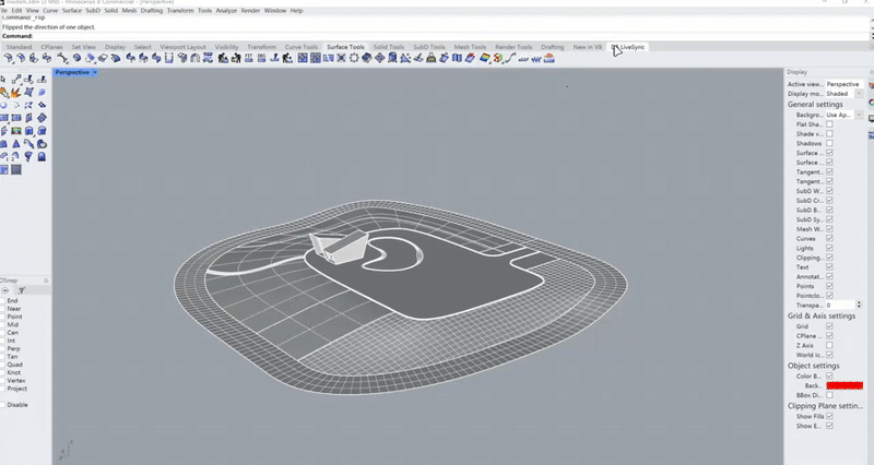

  • Proximity to World Origin: Position your model close to the coordinate origin (0,0,0). Geometry located too far out is prone to calculation errors, resulting in surface flickering or “z-fighting.”
  • Face Orientation (Normals): Verify that all surface faces are pointing outwards. Flipped normals are the most common cause of materials appearing transparent or displaying incorrect shading, which can needlessly disrupt your D5 Render workflow.
How to Render in D5 Render: 7 Essential Settings & Shortcuts
Strategic model preparation prior to D5 Render import

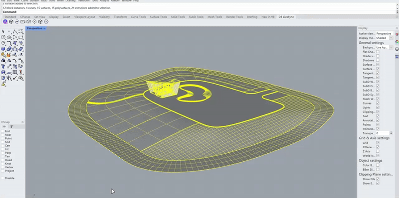

For these scenarios, we highly recommend using the Live Sync plugins with the Grouped Export feature. Whether you use SketchUp, 3ds Max, Rhino, あるいは Revit, this workflow preserves your model hierarchy, allowing you to manipulate individual parts directly inside D5 Render. This is the key to mastering how to render complex, dynamic animations without the tedious cycle of re-exporting your geometry.
Exporting SketchUp models by group via D5 LiveSync
