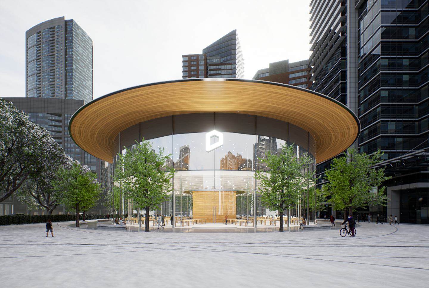

Glass is one of the most common materials in modern architecture/interior design. It is like a bridge connecting the exterior and interior spaces. Though creating beautiful glasses with clear reflection and refraction might be hard in traditional rendering engines, it's actually a piece of cake in D5 Render.
In this article, we are going to introduce in detail how you can make the glass material you need in D5.

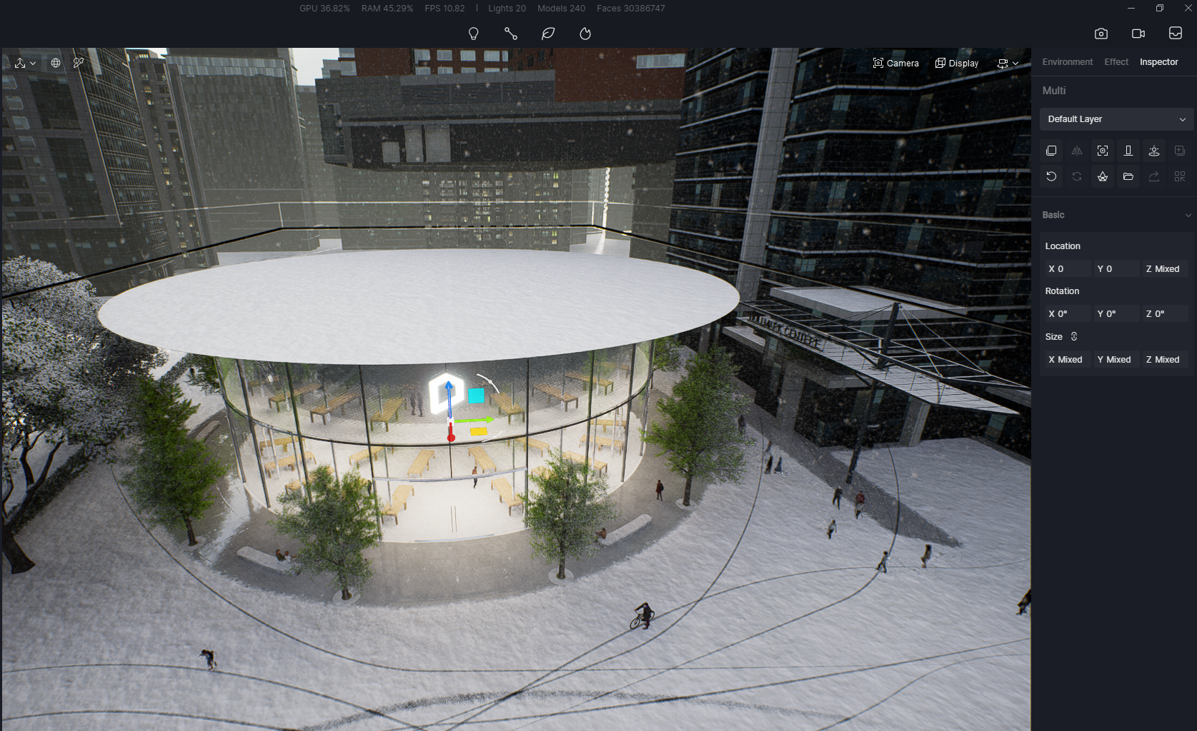

Thickness
Basically, there are two ways of modeling: one is solid-modeling, which means building models in a geometrically correct way; the other is surface-modeling with only visible facets in order to keep the model file light.
When glass materials are applied onto the latter, they may have incorrect refractions. To fix this, you don't need to model in DCC software again. Turn on the "Thickness" option in D5 Render instead. The glass will immediately have a correct refraction, which is quite convenient.

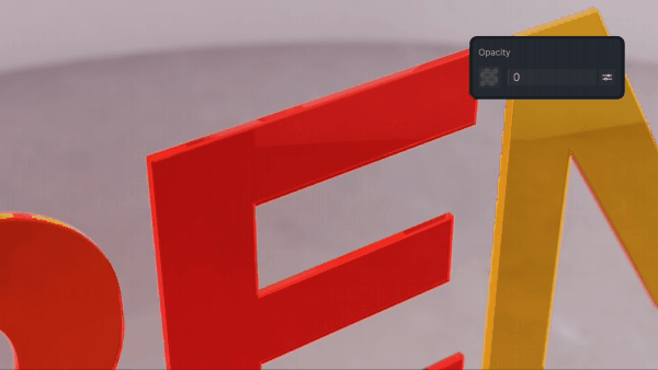

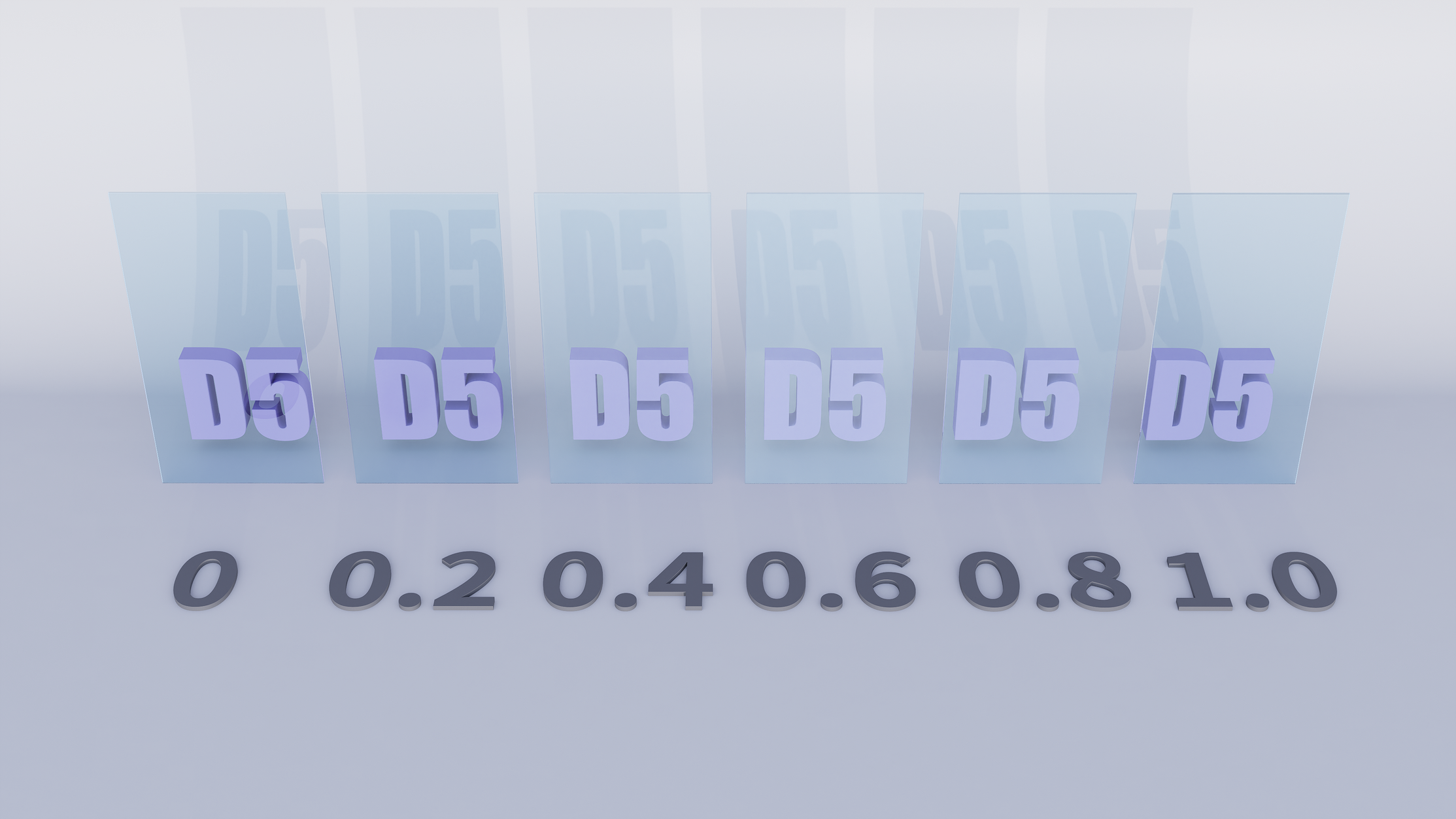

Transparency
By adjusting Transparency, you can decide how much light can pass through the glass material.
Achieve stunning effects like colored gradient glass by enabling the 'Affected by Light' option. Adjusting the opacity value and using black-and-white maps to control the opacity pattern allows for dynamic light interaction.

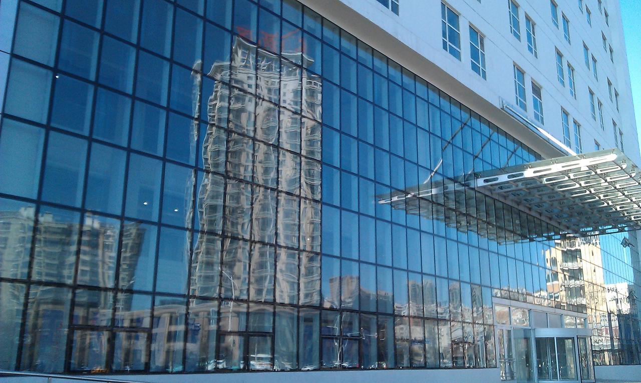

Observing the glass facades in the real world, we can see that they have a reflection looking like waves. That's because glasses usually have slight bumps on their surface due to the processing technology.
So, how to achieve this effect?
You just need one Normal map.
Take this building for example. To simulate those wavy reflections in glass, you just need to import a Normal map, reduce its UV value, and increase the Normal Intensity a bit.
